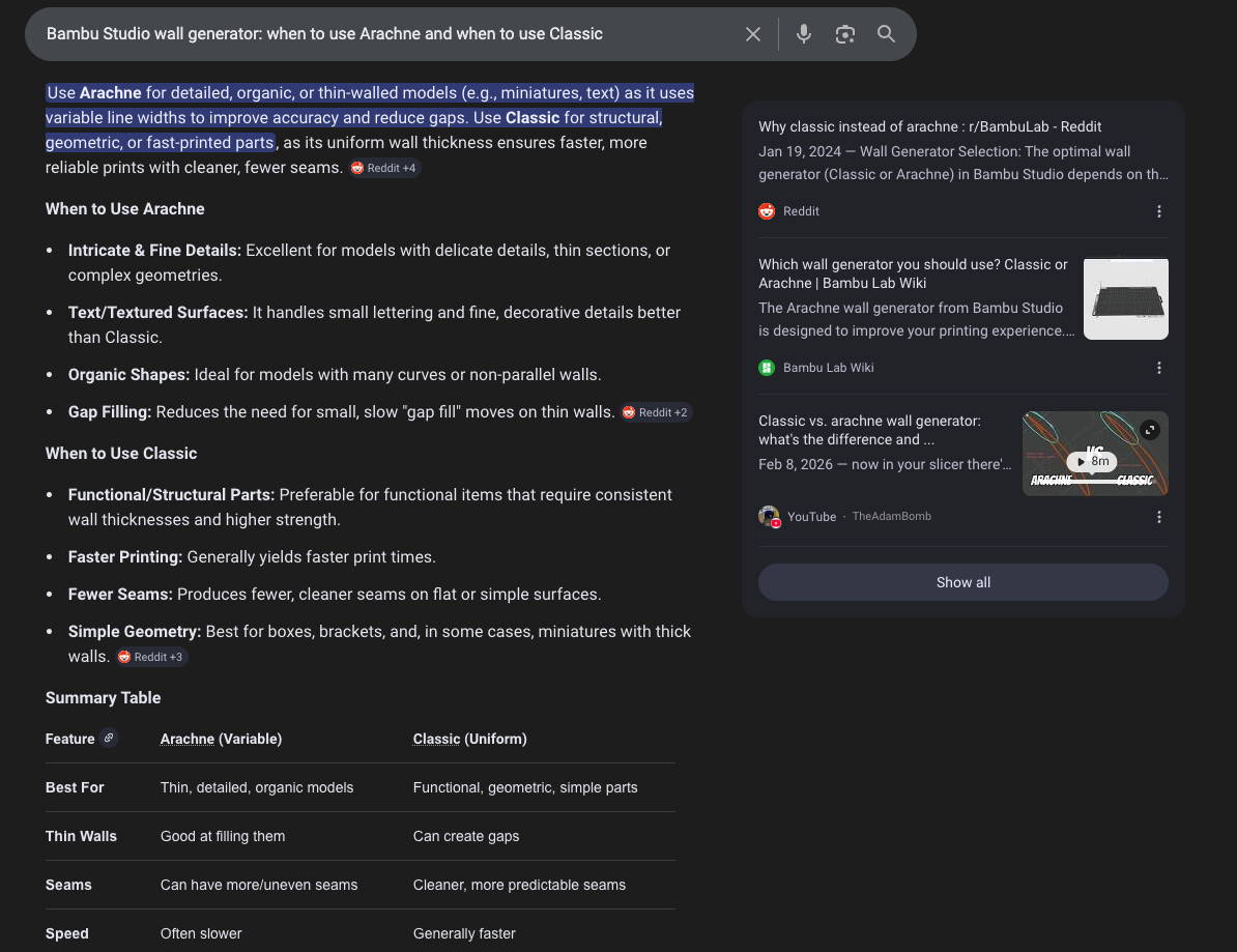

The screenshot below is a Google AI Review, which cites Reddit discussions with links to them. If it is too small to read, type “Bambu Studio wall generator: when to use Arachne and when to use Classic” into Google.
It also provides a link to an article on Bambu Lab wiki.
I myself use Classic as the default because most of my models are functional things.
