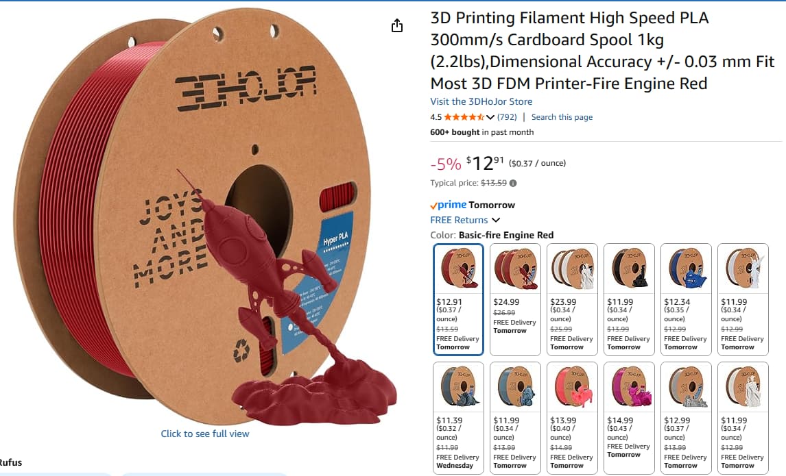

It is nominally red, but it’s also rather washed out, almost like a pastel. This one happens to be a Kingroon HS-PLA, and as far as I can tell, all of Kingroon’s HS-PLA’s are washed out like this, regardless of color. Similar with Sunlu. I just tonight ordered a “fire engine red” from 3DHOJOR (another cheap brand) to see whether it might be any different:
In general I prefer Sunlu over Kingroon, because it has higher volumetric flow rate, and because the prints do come out better overall, but I can sometimes buy Kingroon at close to $8/roll of high speed filament, so I’m willing to compromise for the lower cost and still get higher speed prints. However, I’m still wondering whether the lack of saturated colors in “high speed” filaments holds true for even more expensive brands, or whether this is simply an area where the cheap brands economize in order to be priced inexpensive. If so, then I might still prototype using the cheaper brands but then pay-up for more saturated colors in a more premium brand for the final print.
In the cheap brand category, I generally prioritize Sunlu and Kingroon, which use plastic spools, over brands like 3DHOJOR that use cardboard spools, because the cardboard spools necessitate longer drying cycles in a filament dryer, and because some of them can “shed” bits of carboard and cardboard dust all over the filament, which increases the likelihood of a clog. Likewise, cardboard spools tend to be less reliably AMS compatible.
