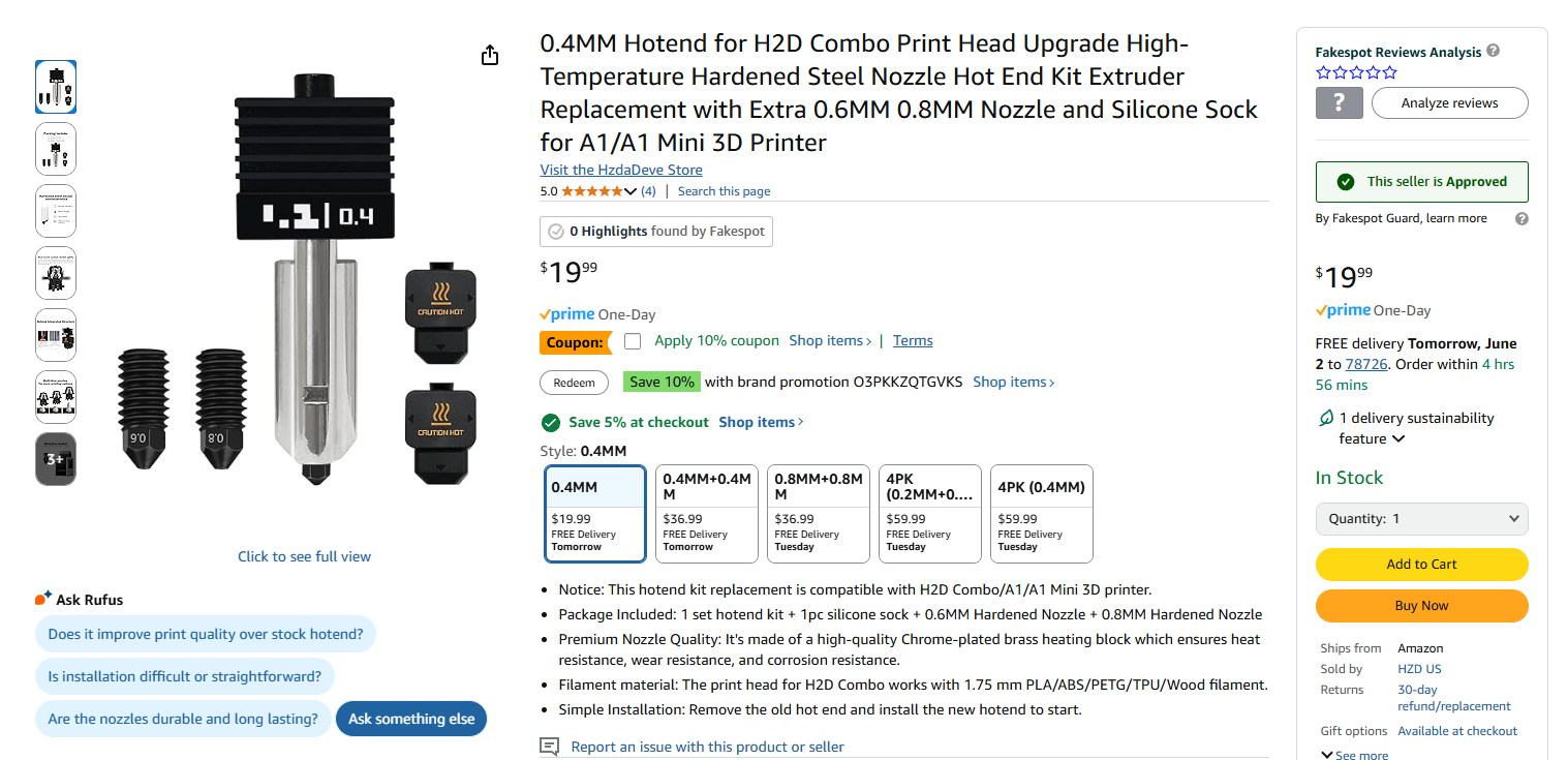

Since official H2D nozzles are seemingly perpetually out of stock on the official Bambulab store (all except for 0.4mm at the moment), I notice that amazon is well stocked with what I presume are knock-offs that look just like the real thing:
Here’s the thing: the title says hardened steel nozzle, but the the description says chrome plasted brass. So, which is it?
Also, if you buy two instead of just one, then the price is well below what Bambulab is asking for theirs.
Most likely it is brass as why else would they specific mention it.
They might be good you need to try and risk it.
But this brand has some reputation in the 3d world
biqu has nice hotents being better then the original.
Haven’t used it myself but you can try.

As per your suggestion, I just now checked the biqu website, but it doesn’t show any H2D hotends or nozzles. Just the blue build plate.
I think it’s both. Brass for the hotend, hardened steel for the screw-in tip.
Is that also how official Bambulab hotend-nozzles are built?
