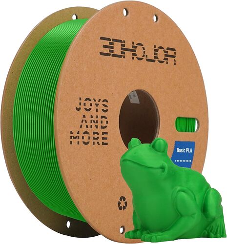

Do you mean this?
Visually it looks compatible. Their product images show it with an A series printer.
Cardboard spools work without issues on the AMS Lite (not as easy on the non-Lite AMS units).
Provided it fits on the spool holder and the filament feeds when you offer it up, it should be good.
The only obvious problem would be a tangled spool. I see this often, maybe 1 in 20 non-Bambu Lab spools. Only very occasionally from Bambu Lab and not recently. This should be visually apparent if you take it off the AMS Lite and manually try to unfurl (spinning backwards, not off the sides) one loop will be trapped under another loop. Manually free this and try again on the AMS.
It could be that has the filament fused together (think sticky spaghetti), I have only experienced this once from over 500 spools.
If you have callipers measure the diameter of filament in several places. If it’s not consistent and close to 1.75mm you might end up with problems. One of the reasons I’ve stopped buying cheapest/ no name brands was because of bold claims of accuracy that were not true.

And, yes, MalcTheOracle, that is the filament(s) that give trouble. Visually, it seemed perfect. no tangles, no fused together stickiness and the cardboard sides seemed to be no problem. Also it fit the AMS spool holder well.
The only issue, as I have said, was it seemed difficult to push through the AMS feeder secion.
