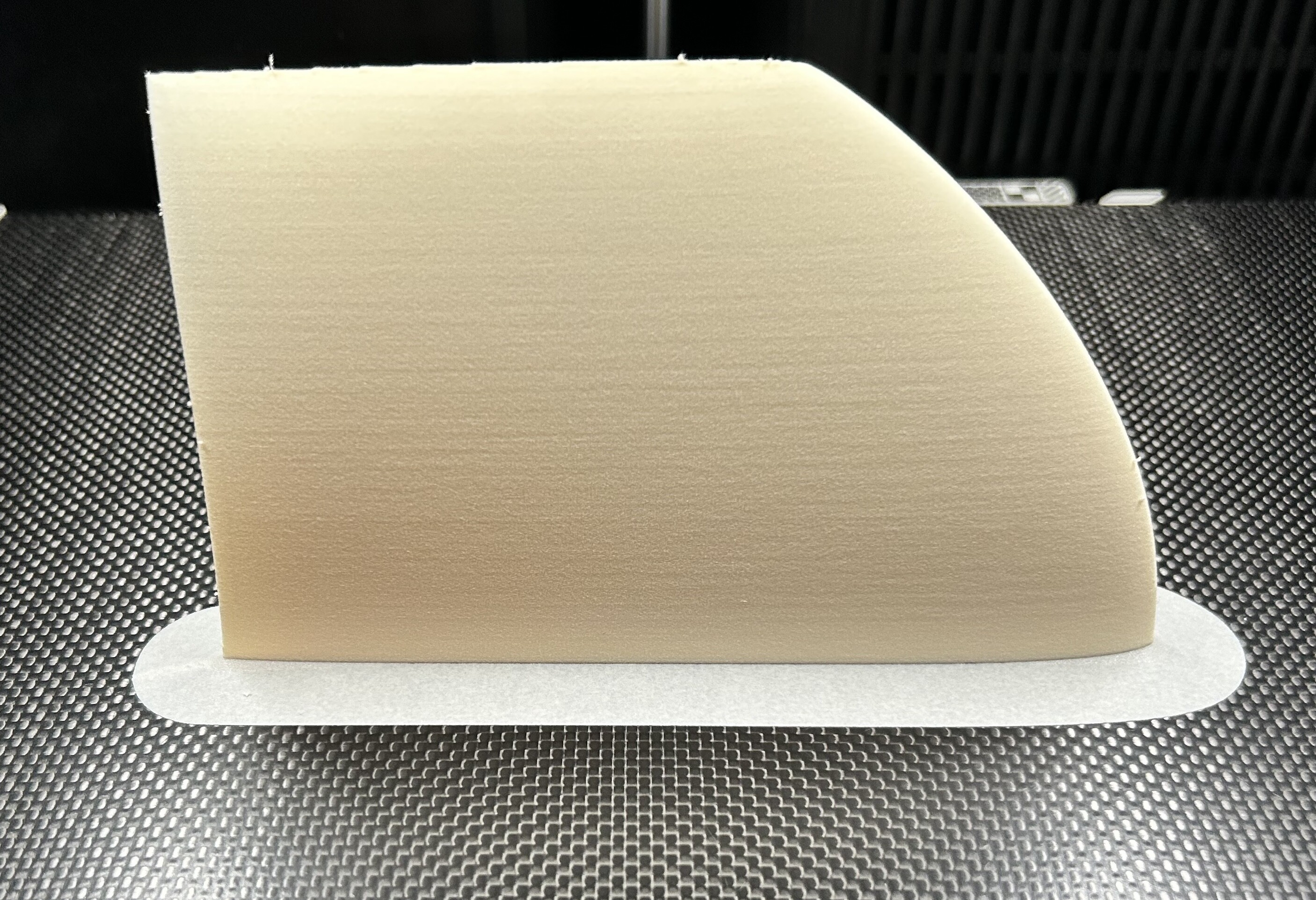

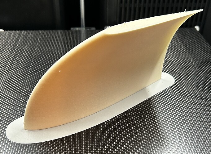

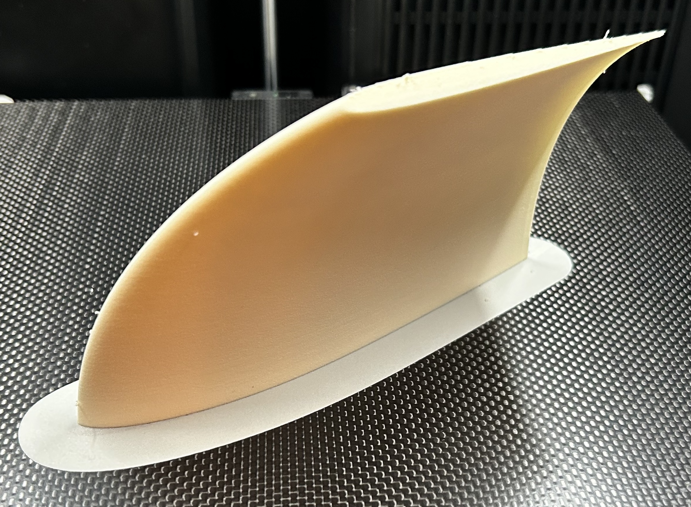

I didn’t have any freshly printed, so I’m printing a prototype of an airfoil section. It should be ready in a few hours. :wink:
Here is my fresh test directly from the printer
They look great, thanks for sharing, I’ll definitely try your setup as it’s always the way to learn…
During this print, I used the following speeds. They might be a bit on the safe side, but for me, having a reliable and functional model is far more important than being a speed demon :wink:
Even-odd mode and a brim were also used.
This profile can also be used for vase mode if desired, but in this case, I printed with 2 walls and 6% gyroid infill.

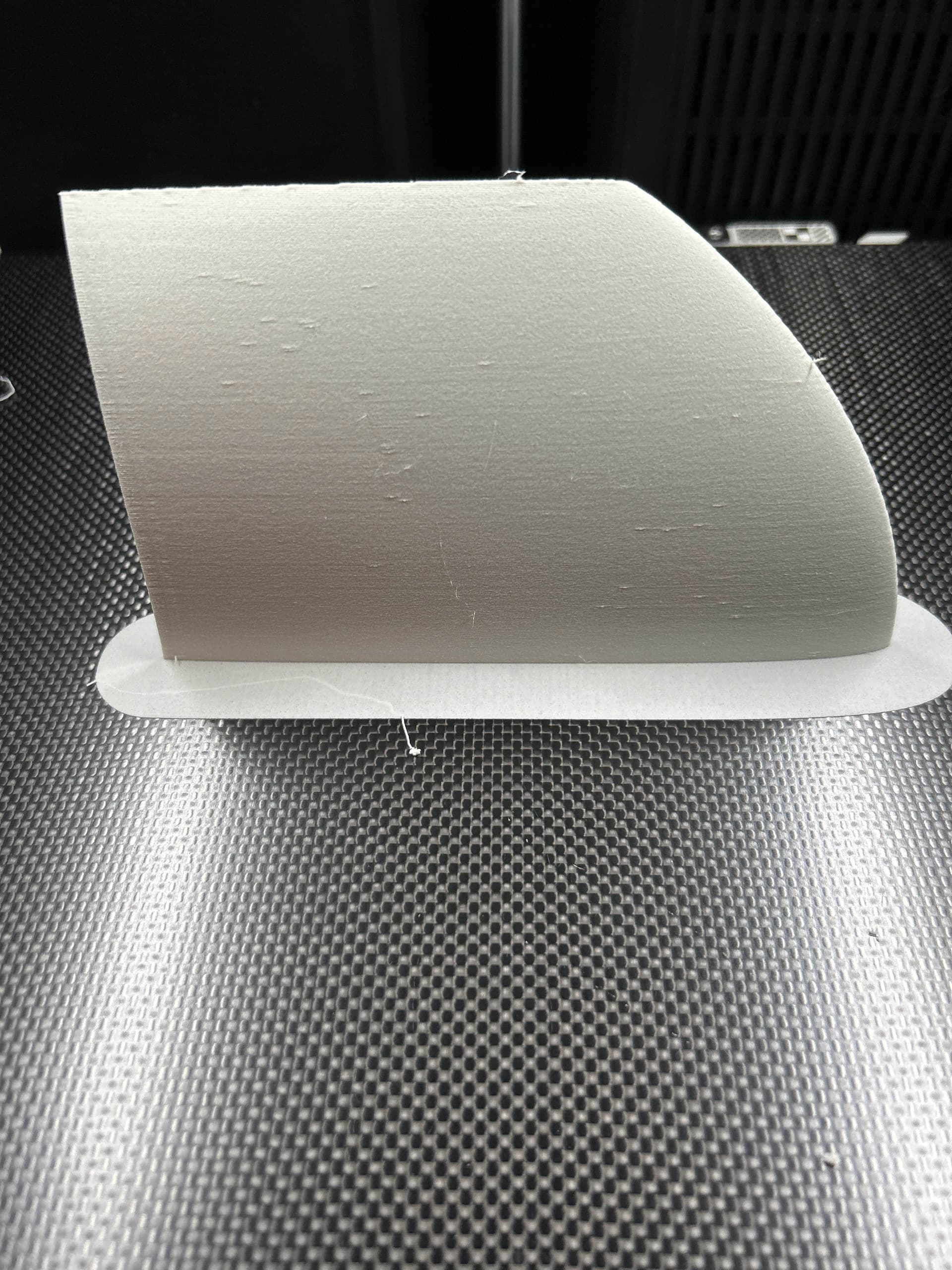

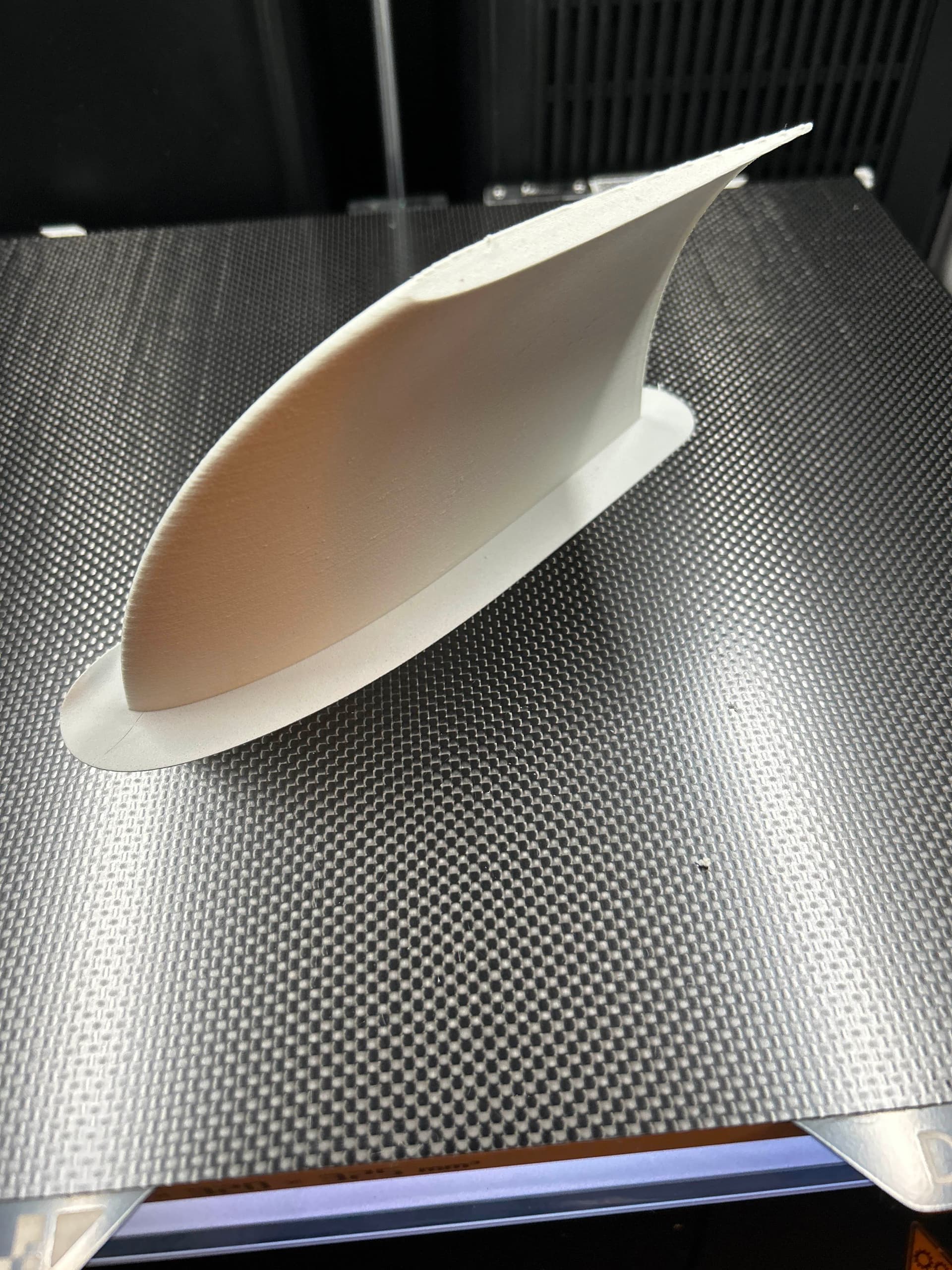

In a few days I’ll perform the exact same ritual with PLA Aero — may the printing gods have mercy on my nozzle! I’m a total rookie with this one, so I just borrowed some wisdom from my ASA Aero adventures and sprinkled in a bit of PLA logic and MVS magic.
If you have any tips, tricks, prophecies, or just random nonsense that might help (or not), please unleash them upon me!
This is the same model I recently printed in ASA Aero, but this time in PLA Aero. The profiles are almost identical, except that I use three wall loops for PLA Aero and four for ASA Aero.
