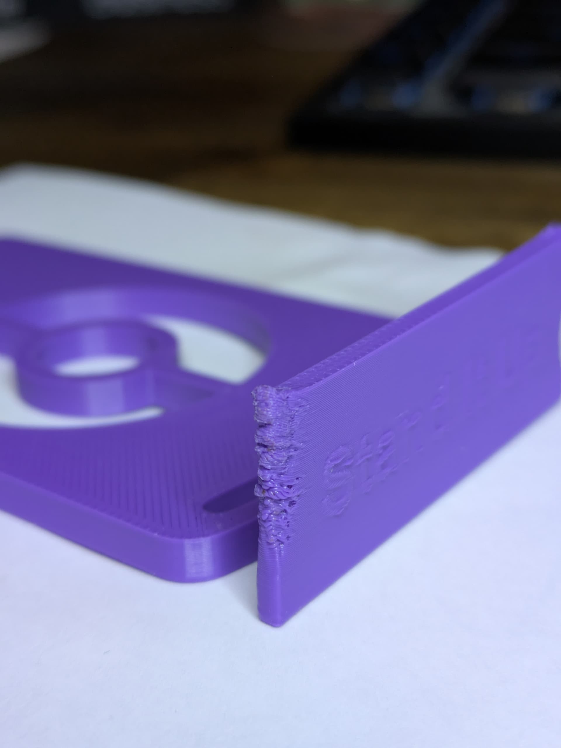

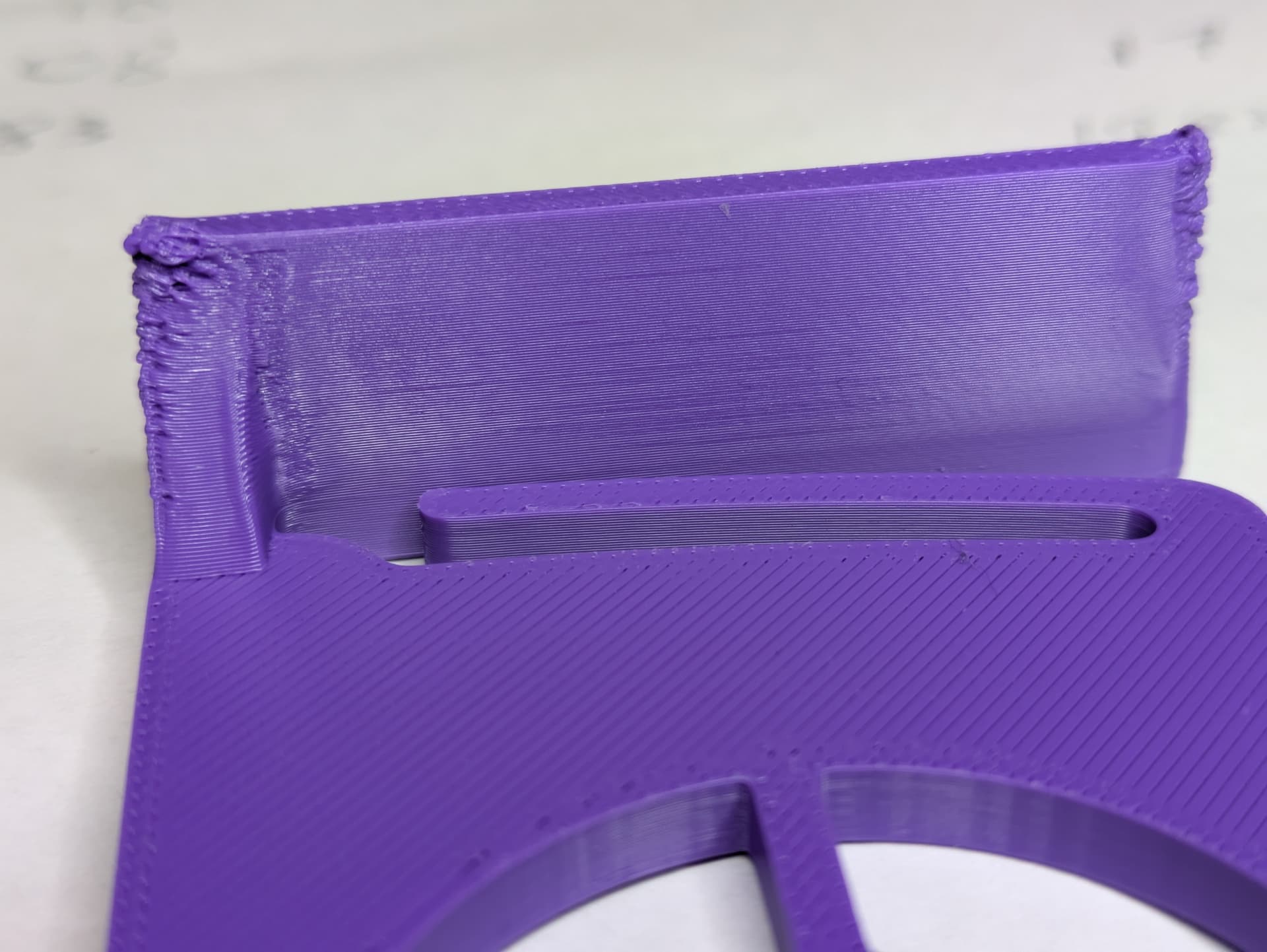

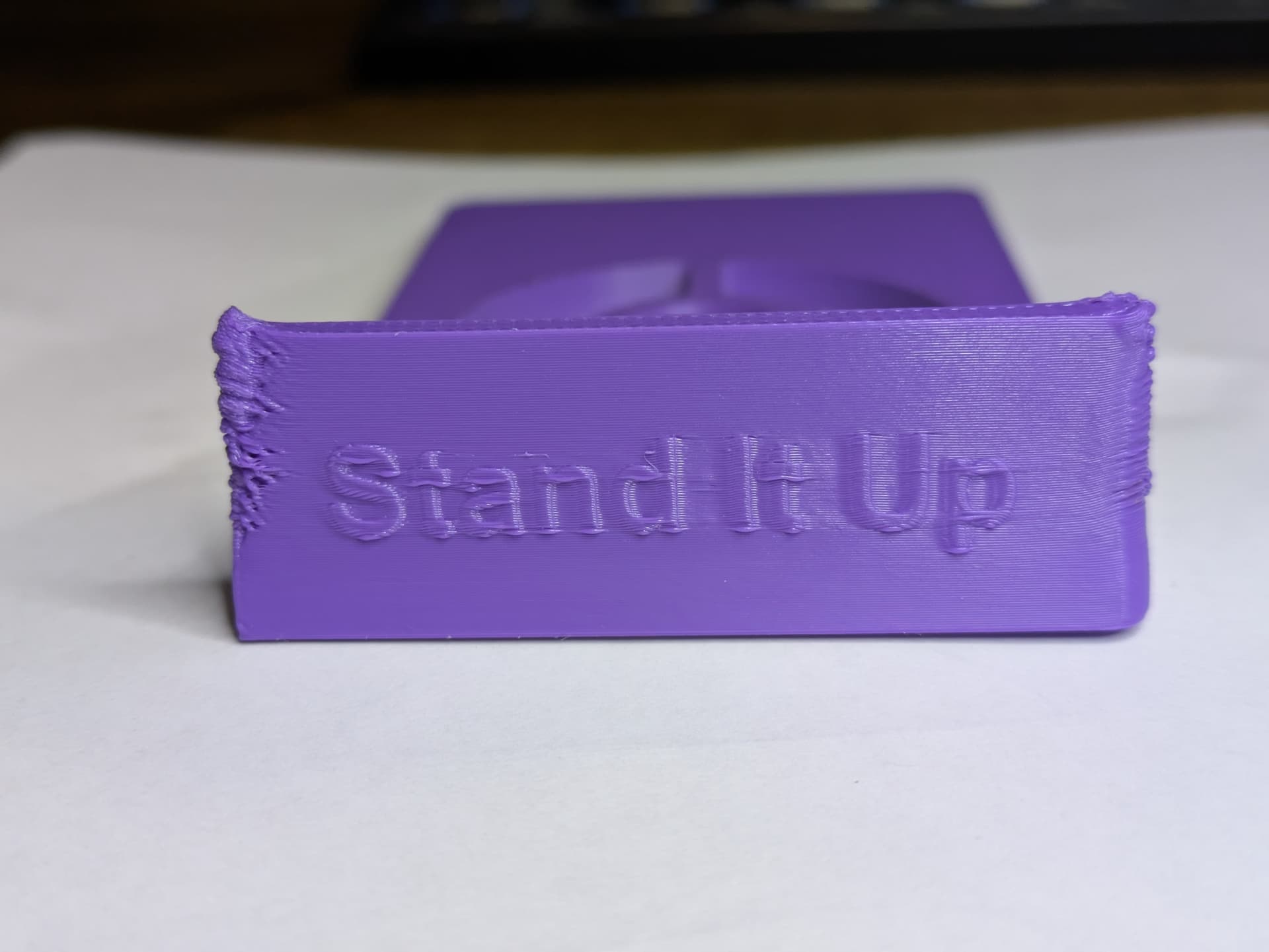

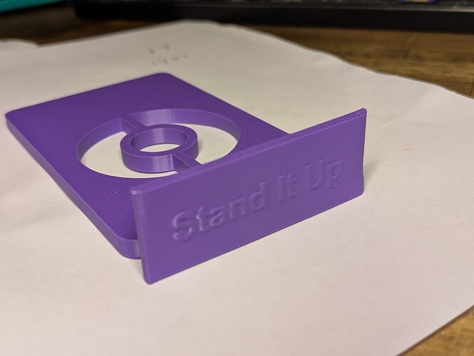

Printing on P1S enclosed with calibrated filament Polymaker ASA. lower layers print fine, no adhesion issues (ignore lift on picture, its on a non-flat surface). Anyone know why it looks like over-extrusion only on the sides and in the text area?
Printer: P1S
Plate: Engineering
Infill: Gyroid
Nozzle: 0.4
Flow: Standard
Filament: Bambu Labs profile, recalibrated for flow rate - Polymaker ASA
I thought maybe its a speed issue? but it looks more like over-extrusion, which is weird given that I have calibrated the flow rates.
Any help appreciated.

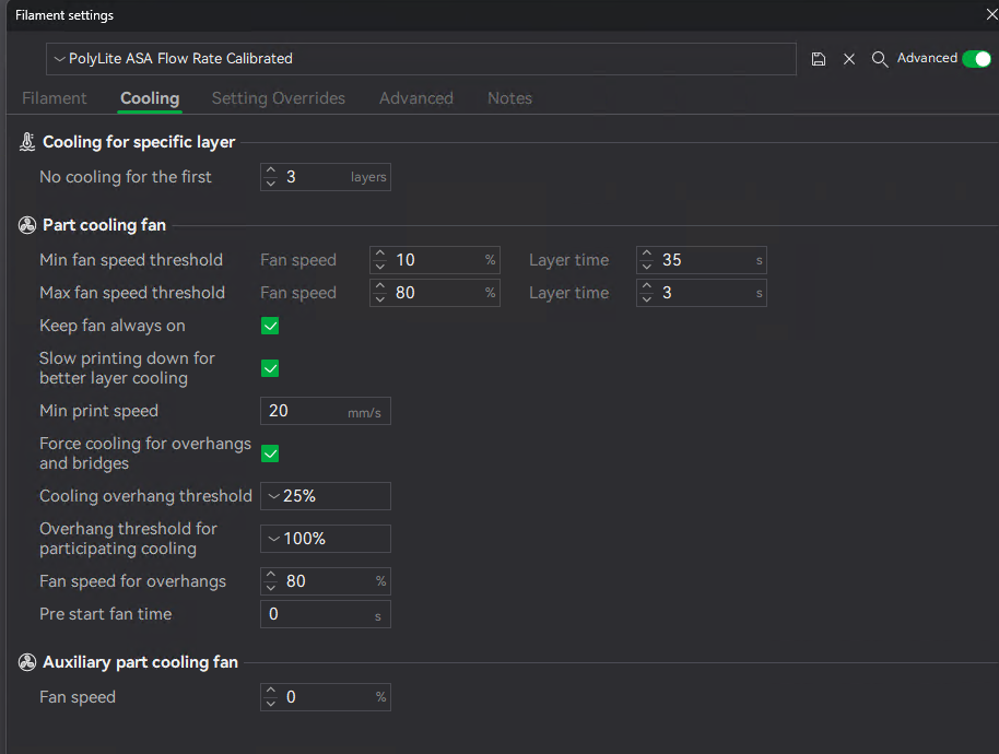

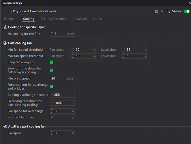

Seems to me not enough cooling
These are my cooling parameters for PolyLite ASA

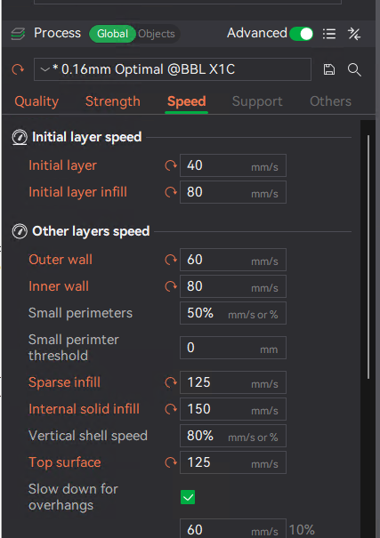

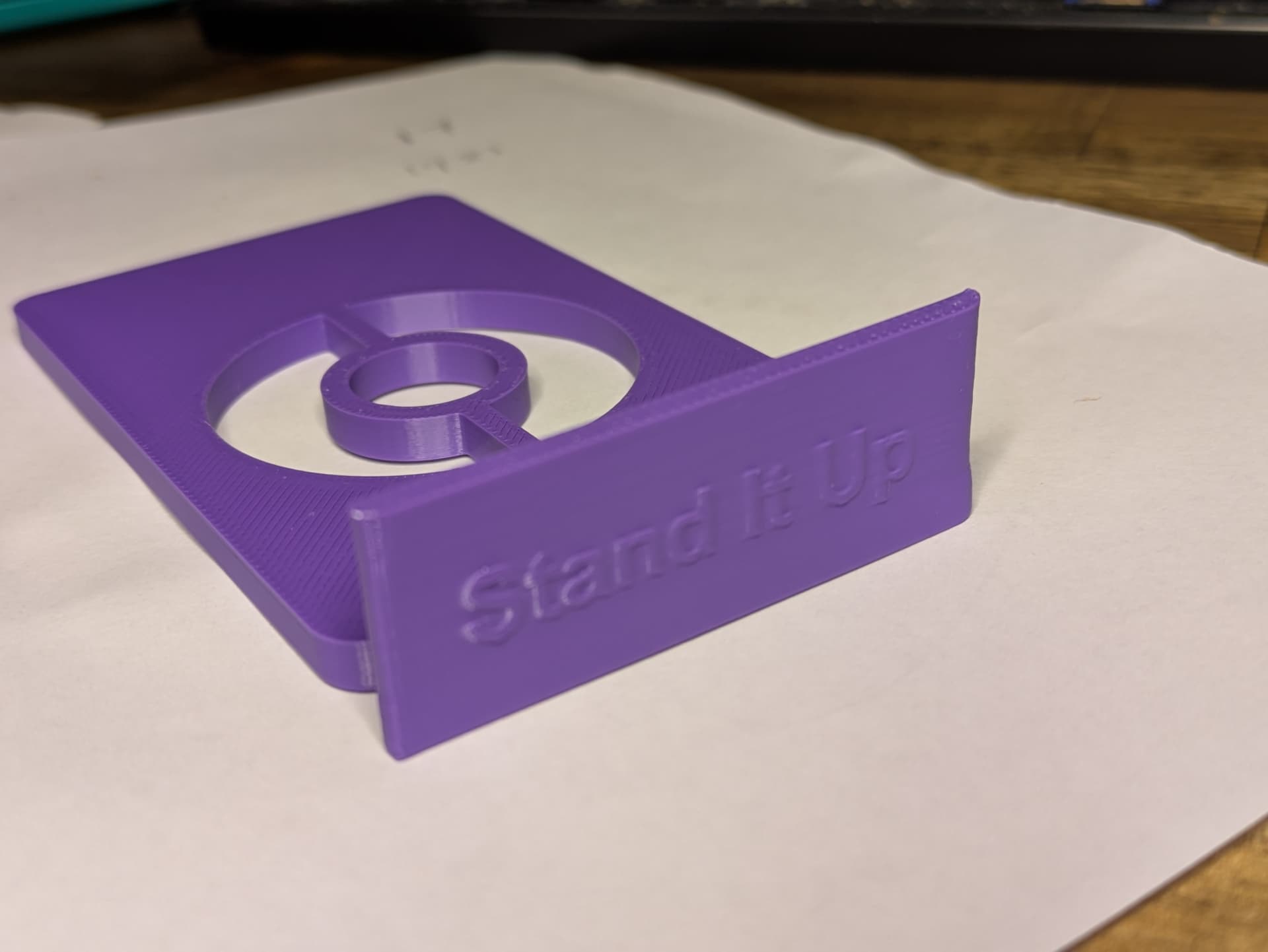

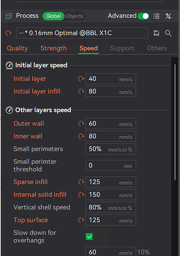

Might have been a speed issue. I halved the speed and the print is much better. No overhangs and cleaner lines. It’s not 100%, there are still some issues with the print (slight warps due to ASA cooling retraction), but its acceptable.
Speed Settings

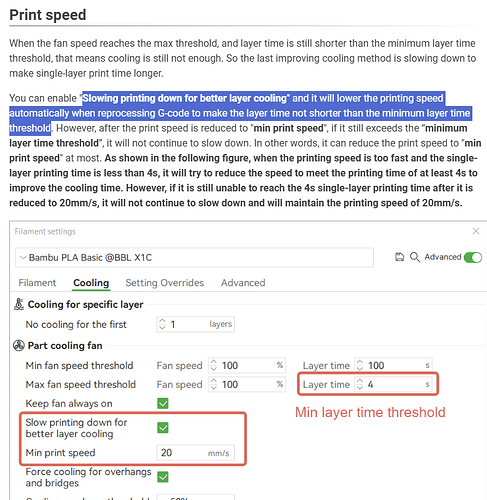

You went in correct direction with less cooling for ABS, I agree that. And you do want to slow down speed to 20mm/s when layer time is less than 3s.
But my guess is this layer was a bit longer than 3s, so this setting wasn’t applied.
Print head still moved at full speed and even 80% fan speed still not enough for cooling those areas.
BambuLab wiki

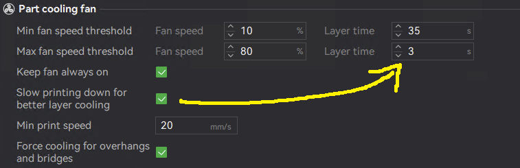

You can manually set print speed as Malc suggested, that’d do.
Or you can let the printer automatically set fix 20mm/s print speed for those short layers by just increase the min layer time threshold to a more sensible number, say 12s
There is more into that if you read that wiki page fully to adjust the cooling for the better
