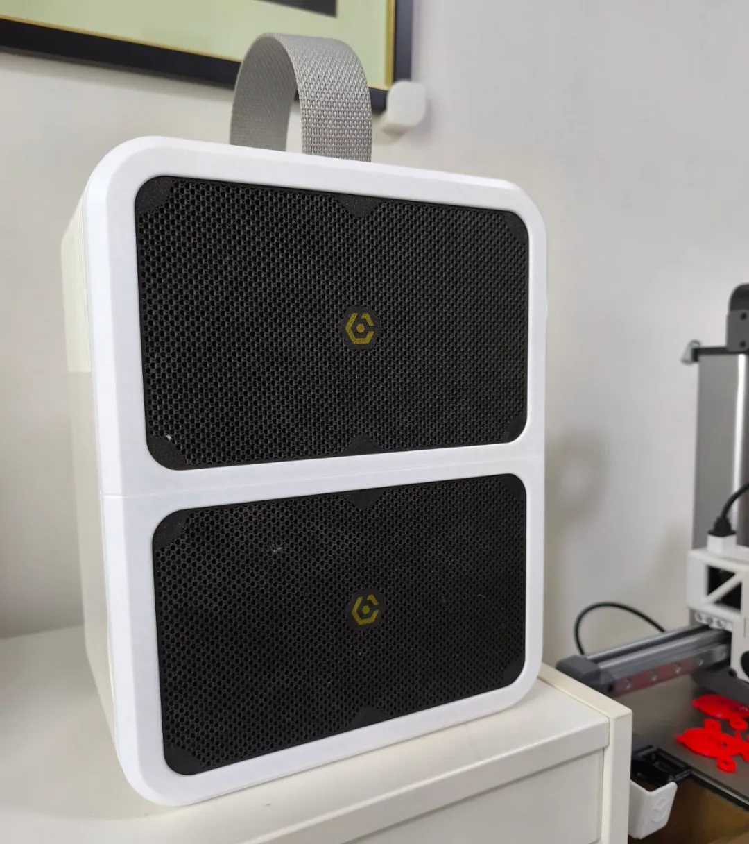

Direct ventilation is always going to score highest for safety, but these days I’m leaning towards adding activated charcoal to your space filtration somehow; and this can earn you occasional non-PLA printing. I’m regarding PLA as safe, I hope, lol.

I have one of these running in the same room all the time:
If I were to print ASA, or any other such material, I would just add one of these, and place it close to the rear of the printer:

  2. Build one of these bad boys: https://makerworld.com/models/1337864?appSharePlatform=copy - the creator is a genius and I believe active on the forums. I have to imagine another layer like this has to put a dent in the odors.
  3. On top of all this, maybe have a small external air filter running by the printer - it can’t hurt and you can keep it in a relatively small form factor. I believe some have already shared some options for these in this thread.
