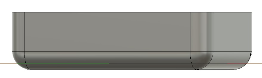

So, based on your experience, could you explain how you managed to print the top part where the fillet is? Because I’m trying to print a 5mm fillet, and each time, the higher the layer height, the more the layers break down.

Alors suite à ton expérience, peux-tu indiquer comment tu as réussi à imprimer la partie supérieure ou il y a le congé ? Car j’essaie d’imprimer un congé de 5 mm et à chaque fois plus on monte dans les couches, et plus elles se délites.
Here is a photo where you can see the layers of the fillet disintegrating, then in the vertical part everything is fine.
I see what you mean now. What’s the angle there? I can’t tell through the print errors.
The angle on my model is 45 degrees.
It’s a 5mm fillet
You need support on the first couple of layers. Preferably with specific support material.
Okay, thank you, I’ll try with a manual support.
Automatic support is probably easier here. I would start at least with a 45 degrees threshold.

When design allows me, I use chamfers at the bottom. A small radius (1mm) might work with the appropriate layer height, but a larger radius usually needs support.

I start with the ASA and proceed by small adjustments; it would be easy to modify my model, but I am stubborn and I want to succeed in printing this 5 mm fillet.
This so much. Radiused corners on the bottom are a great way to visualize limitations with overhangs. I also use chamfers on the bottoms where possible,
