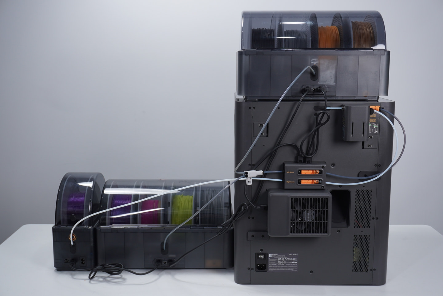

I also did not like the Bambu Lab track switch mounting solution. This vertical one seemed the cleanest as you can print with a built in cable organizer and a cable organizer cover to clean up the look.

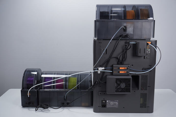

So, according to Bambu Wiki, it should work without a track switch. You have to scroll down to the X2D.
I haven’t tested it myself, but I’m just passing along the information that it should work as shown in the photo.

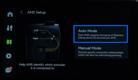

You can assign each AMS to a nozzle (you can assign all of them to the same nozzle if you want) manually directly on the screen of the printer, in the filament section. Select Manual Mode.
Ahh it’s on the printer. Looks like it was a skill issue after all lol. Will check it out in a bit and see what’s going on, thanks :+1:

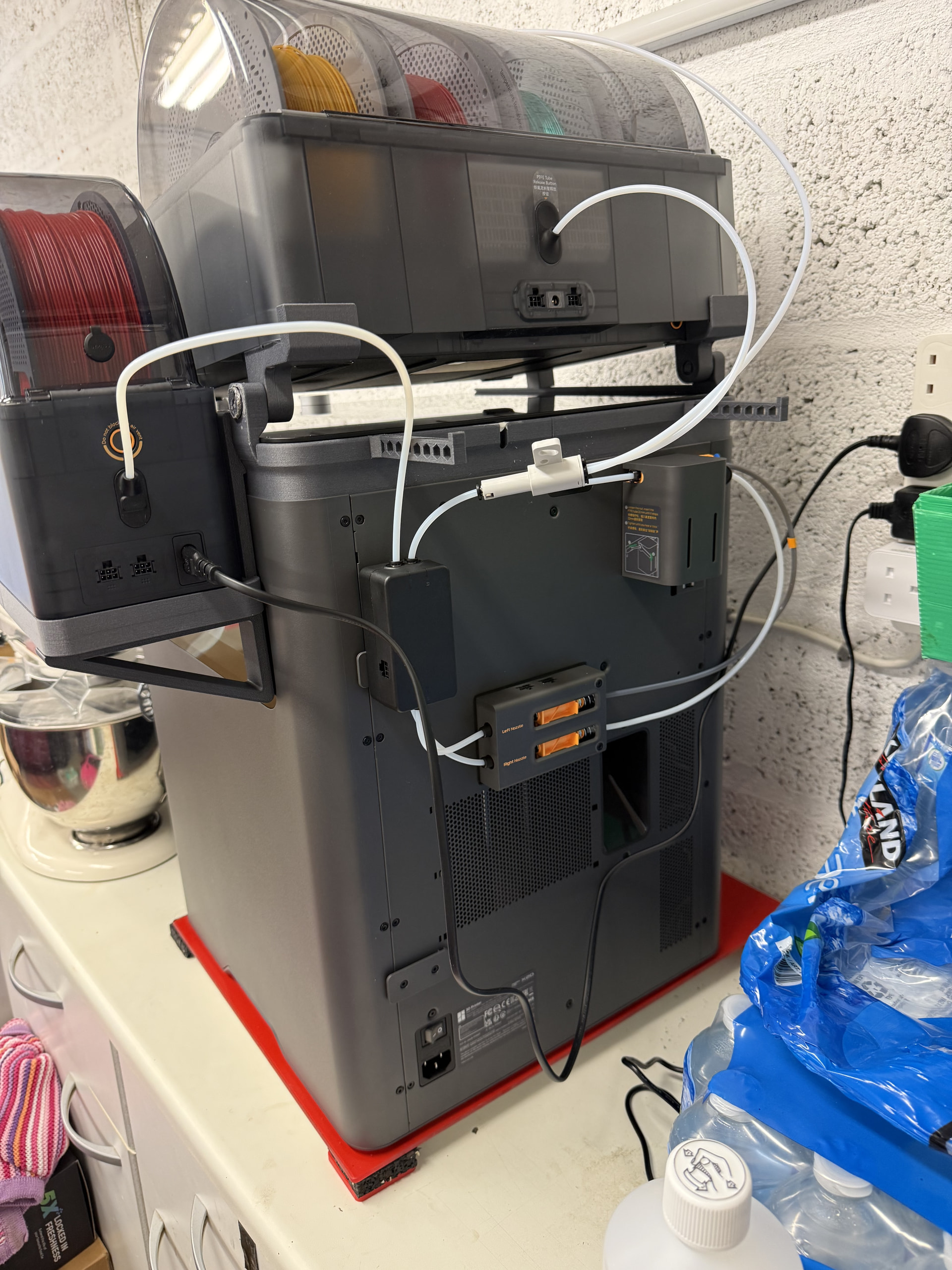

I went much simpler and stuck my FTS vertically on the back using gorilla tape (didn’t need to print anything at all).
2xAMS and 1 AMS-HT and no problems with the setup or filament movement through the tubes over the past few months since I got the system…..I love the automaticity the FTS gives.

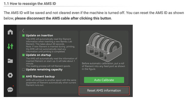

Incidentally do you know any way of swapping which AMS is classed as A and which is B? I tried swapping the cables around but it didn’t make any difference

After reset, connect first the AMS you want it be recognized as “A”.
I’m afraid it doesn’t work for me. It keeps putting the first one I plug back in set as B
You have to disconnect both AMSs from the printer, reset, then connect ONLY one of them, configure it, then add the second AMS.
Figured it out, you have to actually reset while they’re plugged in, wait for the lights to flash, unplug them, then plug them back in. All working now, finally got them stacked how I wanted. Cheers again
