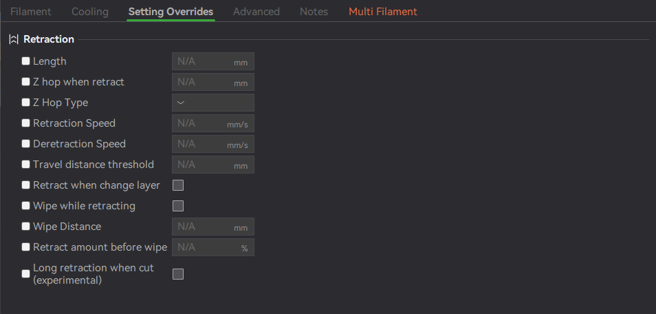

Filament Preset
Based on my above research, I set up a custom filament profile for the allPHA in Bambu Lab:
Full Filament Preset
Most notable are 200°C Nozzle temp, 6 mm^3/s and 100% cooling after the first layer (no cooling on layer 1)

I made some adjustments based on my above notes. Relevant adjustments are as follows:
  • Increased flowrate from 6 mm^3/s to 7 mm^3/s
  • Increased Nozzle temp to 210°C from 200°C
  • Decreased Flow ratio from 1.00 to 0.97
  • Enabled Arachne Wall generation
  • Forced the seam inside the model
  • Added a larger, much higher flow, fan
Full Filament Profile
Updated Slicer Screenshot
The changes are not really visible.
