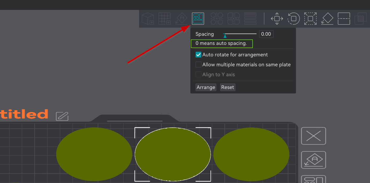

Since the second-to-last update, I’ve been having an ongoing issue where, when I have multiple objects on a plate and use the Auto-Arrange function, Bambu Studio places one or more of the objects off the plate. The objects haven’t been resized and should easily fit on a single plate for printing. It worked countless times before without any problems. The latest update didn’t bring any improvement either.
Is anyone else experiencing the same or a similar issue, and does anyone have any tips or a possible solution for it?

Are the parts tightly spaced or wider gaps?
If any single part has support added, all parts on the plate gain extra padding between them.
If you recently added support to one or more parts, that extra padding may be why.
While I can’t answer why your configuration changed, I can tell you how to fix it.
Click on the arrange objects - hotkey ‘A’. This has more granular adjustment than the
Arrange objects on plate feature.
The default is usually set to 3.81mm spacing.
Change it to zero and click ‘arrange’. If there was enough room on your build plate, it should all fit.
You want auto rotate also turned on to allow the slicer to rotate the objects for best fit. But to be totally honest, I found that the slicer’s rotate function to be very hit or miss and I’ve had better luck rotating the objects myself first then using the arrange feature.
