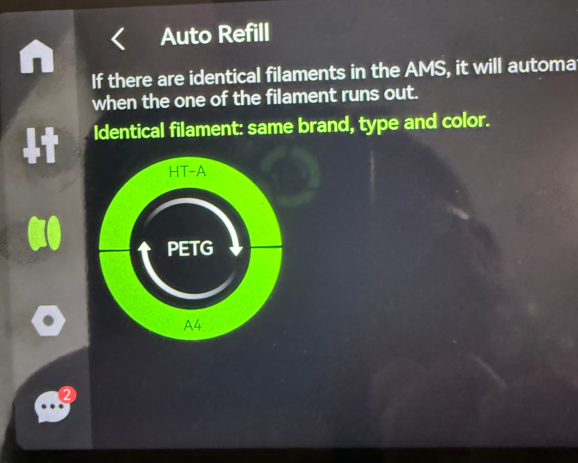

I have an AMS 2 Pro and HT connected to a H2D printer. I have Auto-refill enabled and if one of my spools runs out in the AMS, it will automatically switch to another spool. But twice now when the spool runs out in the HT, even with an identical color/type spool in the AMS, it will not switch. The printer will not resume unless I replace the empty spool in the HT. Anyone else having this issue or is this working as designed?
I guess it’s just not setup (on a firmware level) to use a combination of HT and regular AMS systems.

I think Auto refill will only work if there are 2 or more slots in a device. Since HT is a single spool, it doesn’t have that “slot” to refill from, that and not ready for prime time programming. Logically it should work, but an HT is not an AMS and an AMS is not an HT. Has it been tried with a pair of HT? Maybe that combo will work.
I also ran into this issue today, looks like the requirement is you can only use the auto refill per each nozzle (left or right) on the H2D.
This essentially means you can’t auto refill with the AMS HT since you can only have 1 spool in it (unless maybe if you have 2 HTs and daisy chain them together?).
Found it mentioned on their Wiki:
wiki. bambulab. com/en/ams-ht/Intr-to-ams-ht-workflow-and-features

I had basically nothing to lose, so I just tried this on my newish H2S. Both rolls are RFID bambu (I’ll some generic next)
Low roll is on the AMS HT and new roll is in AMS 2 Pro
But that is both into the same nozzle correct? I am thinking that is all that matters and just want to confirm for everyone on this thread. It does make sense so you aren’t loosing calibration by reloading a spool into the other nozzle.
Since my last post, I now have a second HT and have reloaded perfectly fine from one to the other with them both fed into the left nozzle. On another print, I went through 3 remnant rolls into a full roll that were loaded in my AMS2 with no problems at all.
I have a H2S - so, only 1 nozzle to choose from :slight_smile:
There has also beem some chatter about going from AMS to HT and back would also cause problems for auto refill, I was also pointing out that isn’t an issue.

I think auto refill only works in same unit, and not across units. I tried it, but because it was on a different head, it disabled auto refill.
So with AMS HT, this feature is no feature ^^
I just used auto refill from a AMS2pro to a AMS HT not 20 minutes ago - this was on a H2S, but it certainly worked.
