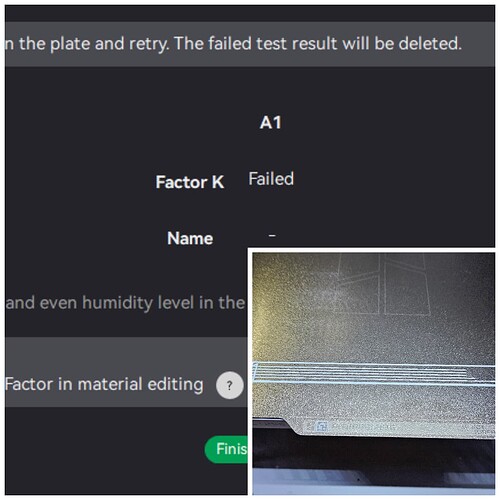

Automatic Flow Dynamics fails, white PLA+
As the title states, I cannot get a successful automatic Flow Dynamics result.
Dry filament, white PLA+
Texture bed
Cleaned the lidar lens with a microfiber cloth
Completed full system calibration
Latest firmware
It’s been failing for the longest time but white on textured plate shouldn’t fail.
Also Auto Flow Rate Calibration works very well. It’s the Flow Dynamics that fail, no matter what color or type I use.
Have you tried on a smooth plate?
The flow rate calibration works perfectly on the same textured plate and filament but fails 100% of the time with the Flow Dynamics test.
I think the flow rate test varies the amount of flow while the nozzle travels at constant speed. The LIDAR measurement measures the line width, and result is the flow rate which matches the desired line width. The textured plate might cause some variation in the measurement, but it would average out.
The flow dynamics (pressure advance) test makes changes in the nozzle speed, increasing and decreasing the speed of the nozzle as it would approaching and leaving a corner. Moving in a straight line, this results in thick and thin “bumps” in the line. The Lidar evaluates the bumps and tries to adjust flow to match the changing nozzle speeds to produce a smooth line of consistent width. A textured plate complicates this evaluation as it adds random “bumps” to the line which cannot be distinguished from the intentional pressure advance changes.
Calibrate your filament manually, preferably on a smooth plate, save the results, and turn off the pre-print automatic calibration. You will save time and a little bit of filament on every print using that filament and your calibrations will be more accurate.
