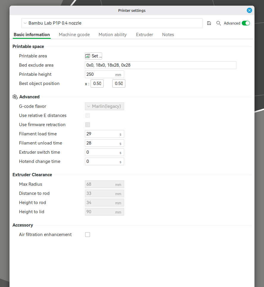

Under the machine profile I don’t see that option
And under printer parts all I have is:
On the printer itself, all I have are the Nozzle choices and the flag for the Enclosure Kit

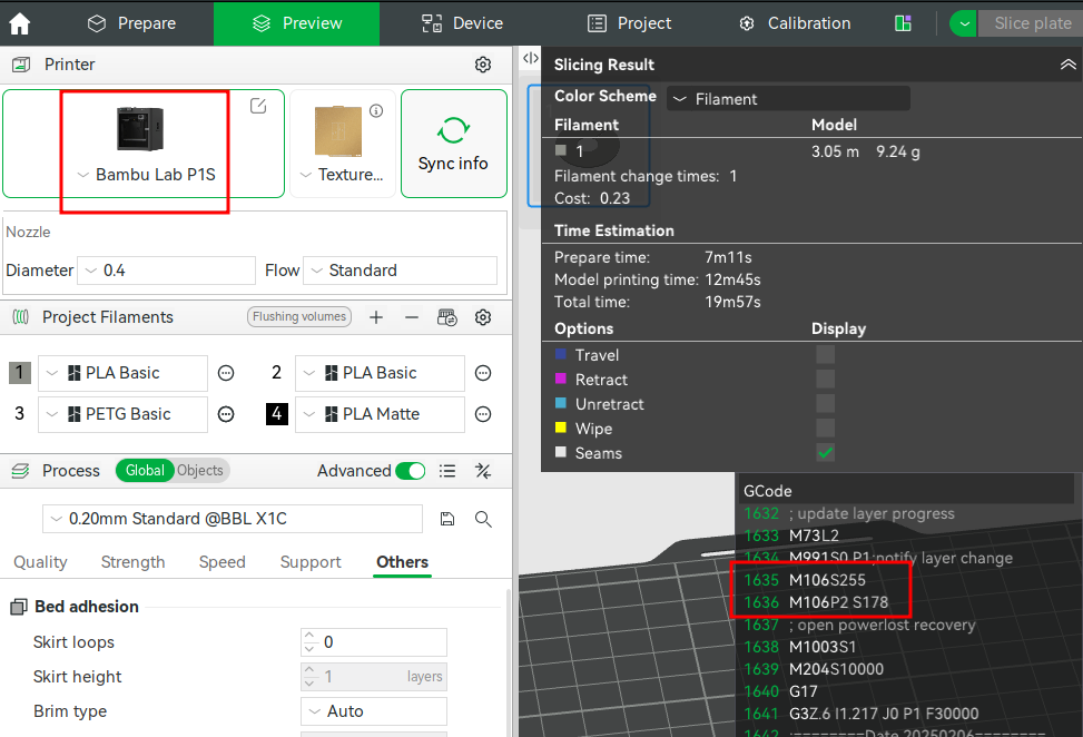

OK, I think something is broken in BLStudio because if I set my printer as a P1S
It correctly inserts the M106 P2 XXX code.
If I select the stock P1P profile:
The command is never generated, I assume they broke the profile then.
Even turning on the Air filtration enhancement doesn’t change anything
I guess technically there’s nothing stopping me from setting my printer as a P1S right?
They have the same functionality and my printer is fully enclosed, so they should behave the same way.
Raised a ticket on GitHub for it: M106 P2 code is not emitted for P1P printers · Issue #9124 · bambulab/BambuStudio · GitHub
Looks like they broke it somewhere between 2.2 and 2.4.
Since it’s enclosed it’s better to use the P1S profile anyways since the P1P profile has some differences that account for the lack of enclosure.
