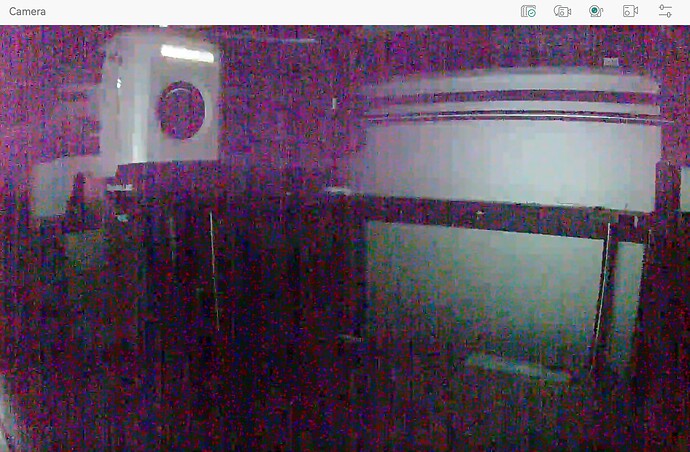

This is the image quality I’m getting via the slicer on my X1C. Is this a bad camera or a bad mainboard? Printer prints fine, just a bad image.
Had same issue. Camera sensor is bad.
Open a support ticket with Bambu. They replaced mine even though was out of warranty.
No guarantees but worth a shot.
Same here. Old camera had problems when temp went too high. Replacing the camera was easy.
