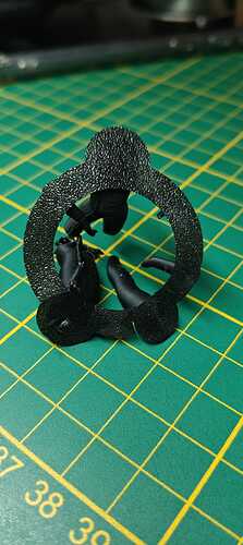

Hi, I’m new to 3d printing and recently bought an A1.
I printed some minis using the stainless steel 0.2 nozzle and it worked well.
Unfortunately, in the last few days, I have started getting some failed prints. I noticed that my support brims are somewhat weird. They look “grainy” and not thick enough. I’m honestly not sure how the other ones (before I got failed results) looked since I started actually paying attention to them after the failed ones.
I noticed that the prints are falling because these brims are disconnecting from the bed mid-print. Since that didn’t happen before (my first 10 to 15 prints), I wonder if something broke.
I’m using the regular 0.08 profile on Bambu Studio, Bambu Basic PLA, default settings + Supports enabled (Tree Slim), and Texturized Bed from Bambulabs.
I also tried with Orca slicer, and found the same issue.
I’ve printed AMS Lite enclosure and my filaments enclosure is stuck at 10% humidity levels for days at this point. I wonder if it could be humidity?
Some photos as reference:
The brims look terrible. I don’t care about their looks, since they will be removed anyway, but I suspect it is not offering enough adhesion. I also wonder if this is a first-layer issue only or specifically related to support brims.
Any tips on how to solve this would be greatly appreciated. Thanks!!

This is a tree support brim from one of my recent prints with the 0.4 nozzle. It looks fine to me. There were 0 issues.
These look way better.
Maybe the 0.2 nozzle is so thin that the melt filament gets into the little gaps on the texturized bed?

I was going through some discarded supports and found this:
These are support + brims from a mini that I printed a few days ago with the same .2 nozzle. There’s clearly a difference between them.
So something definitely changed.

Since I’m new, I can’t really say, but do you think the support brims look okay on my first picture? Also, do you have any clue what could cause such a difference compared to the ones I had before?
Edit: yours looks way better. It seems that it Is a solid thing.

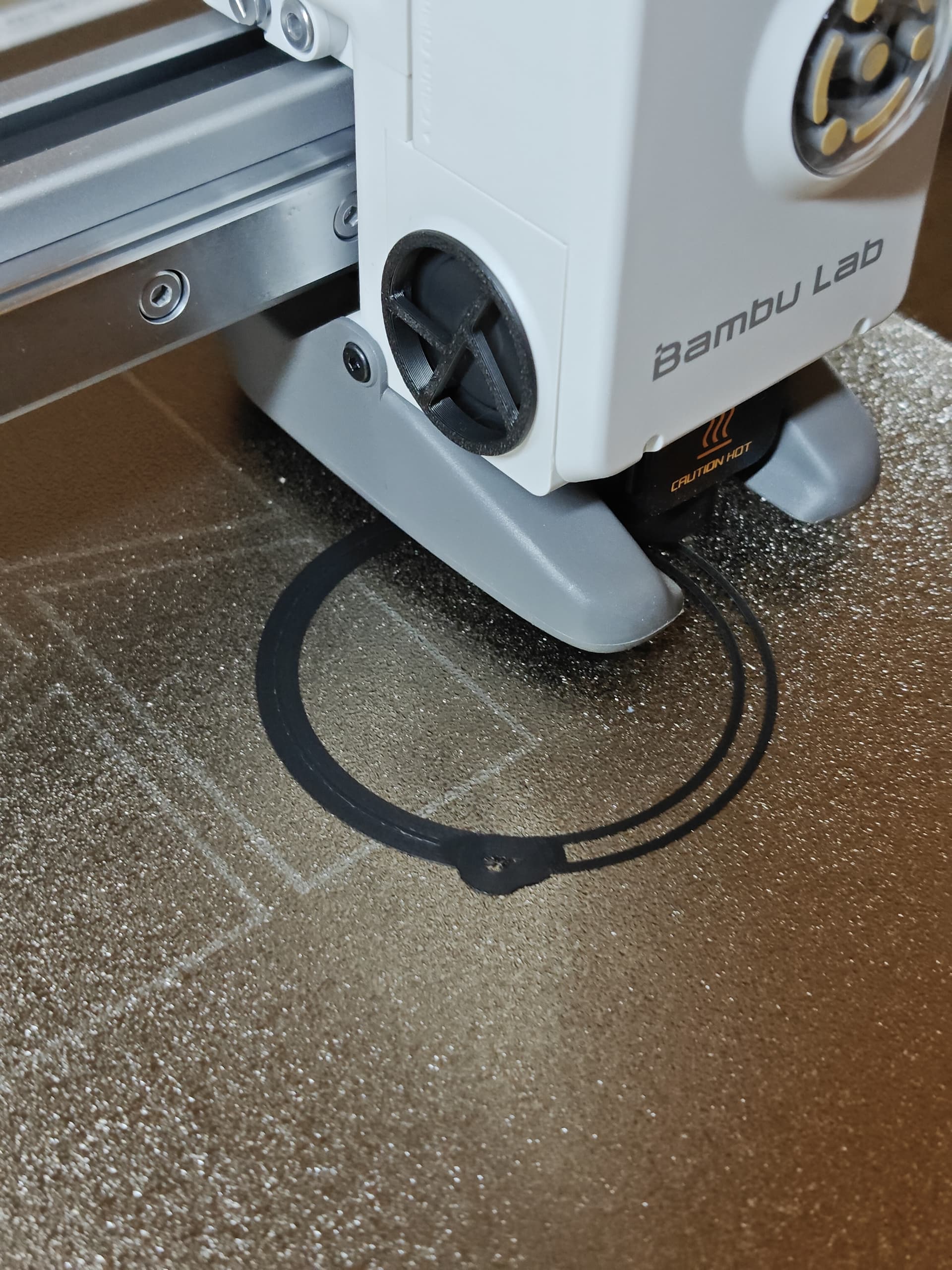

Quick update.
I printed a small mini with the .4 nozzle, swapped back to the .2 nozzle and the issue seems to be fixed.
This is an ongoing print. The supports and brim look 1000x better, as they used to look like before.
Could be the Dynamic Flow Calibration that fixed the issue?
