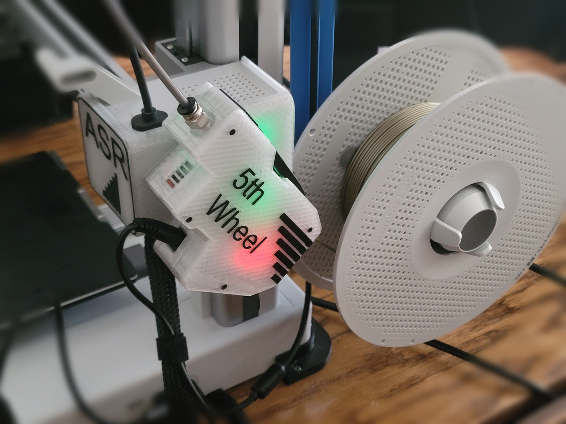

So I spent the last several months building the ASR 5th Wheel, an auxiliary filament management device that mounts directly to the X-axis motor housing and moves with the gantry.
Here’s what it does:
  • Detects filament insertion and autoloads
  • Maintains filament tension continuously during printing using a Hall effect sensor
  • Receives Feed and Retract commands over WiFi, triggered automatically by MacroDroid responding to Bambu Handy notifications
  • Handles the entire filament change without any user interaction
  • All of this without physically connecting to the expansion ports on the printer
I’ve run it through 1000 consecutive automated cycles with all types of filament my Mini can use without a single error.
The hardware is ESP32-based with custom firmware I wrote specifically for this application. The enclosure is 3D printed for now but I’m working toward a more polished production version.

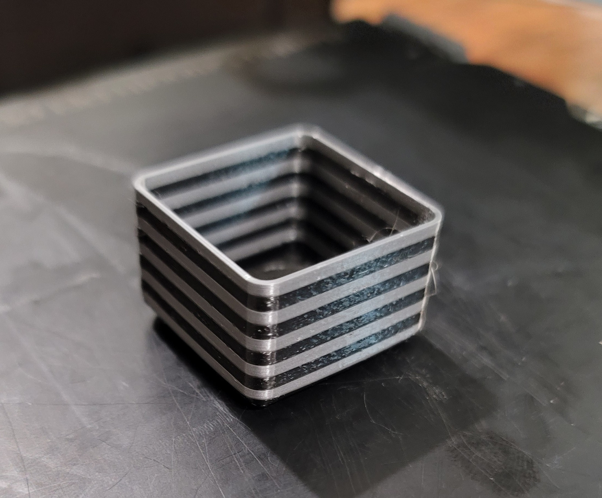

So the answer on TPU is; Yes, not a problem. The V2 Hall Buffer and revision of the firmware worked great. I set this printing before I stopped for the night last night and was very happy to see it this morning.
The Overture Space Gray PETG was in position 1 of my AMS Lite and the Overture Std Black TPU was on the ASR 5th Wheel. The test is only 10 filament changes, but it is perfect and the bonding of the PETG and TPU is strong and flexible. I’ll be running it through 100 filament swaps today, but don’t expect any issues.

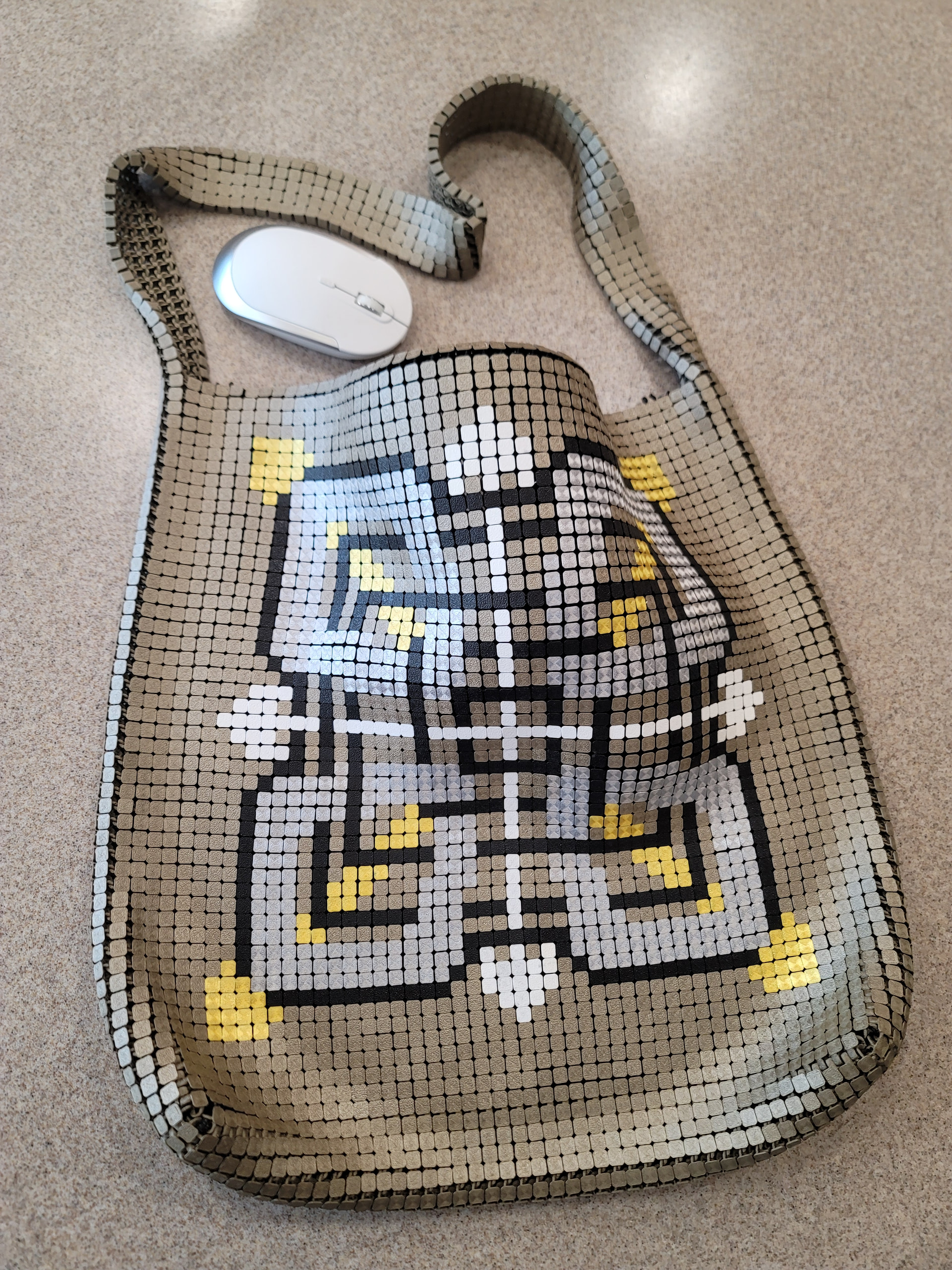

That is exactly what it does. That is why we are calling the product ā€œ5th Wheelā€. It does not connect to the printer with a cable but rather responds to prompts in Bambu Handy. That way, hopefully, we will not have to deal with interfering with any of Bambu’s proprietary Bambu Bus communication protocols. Here is a print I made using the ASR 5th Wheel that has about 140 hours of unattended print time in it. It was printed in 5 colors all fully automated; Bambu PLA Metal Gold, Bambu PLA Matte Ivory White, Bambu PLA Matte Charcoal, Bambu PLA Silk+ Gold, and Bambu PLA Silk+ Silver. (The mouse is for scale)
Absolutely brilliant.
