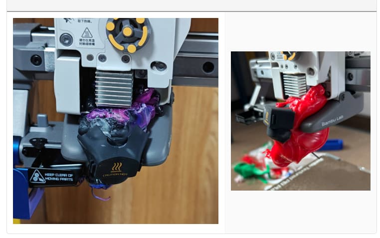

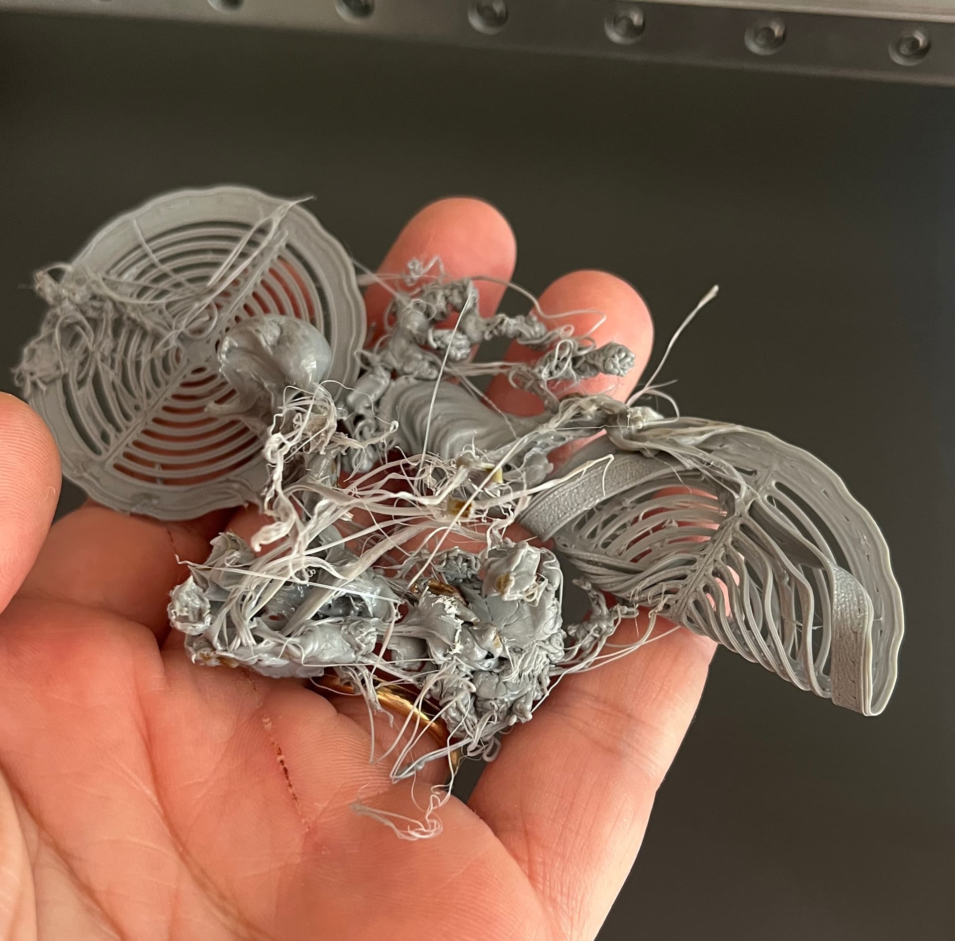

BUT the honeymoon with the A1 is over. For the third time, the printed part detached from the textured plate mid-print, and the printer kept going, almost destroying itself.

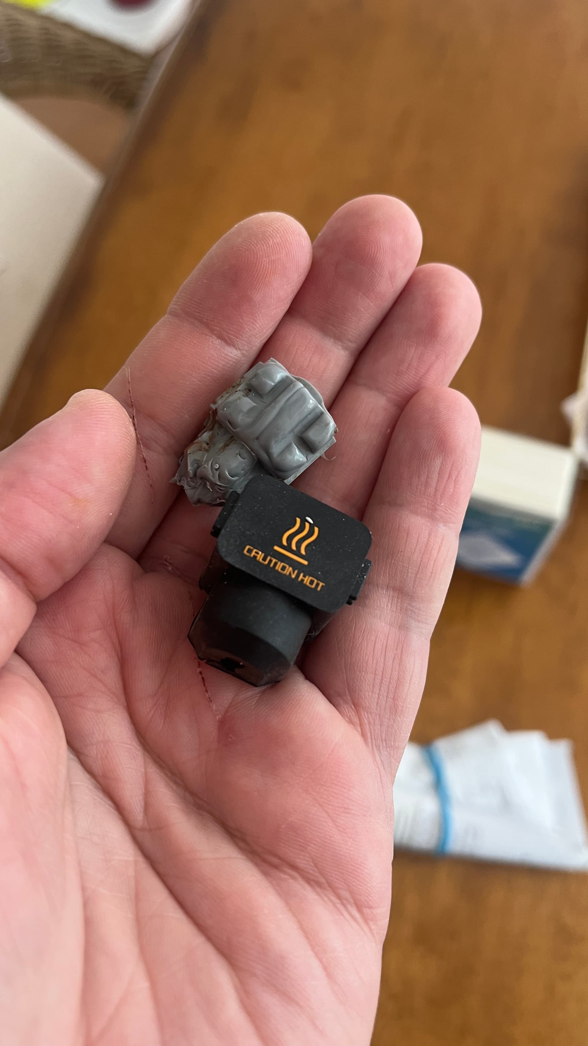

The first time this happened, I broke the thermistor wires trying to remove a massive blob of melted plastic that had backed up behind the hot end. The wires are extremely thin, poorly positioned, and unprotected.
As a designer, I have to say this feels like a design flaw. There should be something preventing melted plastic from backing up into the print head—it can lead to major damage and is a nightmare to clean. Also, the hot end latches are fragile and badly secured. One of mine snapped while I was cleaning up.
A small design change, like a cover behind the nozzle or a tweak to the fan assembly, could probably avoid all of this.
In 10 years working with 3D printers, I’ve NEVER had an issue like this—until the Bambu A1. None of my other printers would suffer from this because there are no “caves” around the hot end for melted plastic to get into. I really hope the BambuLab design team comes up with an updated part to fix this.

I’m not hugely popular on this forum because of my overt distaste for these printers and their features but the hotend portion of the A1 series is so bonkers-cheap and easy to replace that its really difficult to be annoyed at them for this. it’s something like 20 bucks CAD for me.
Don’t get me wrong; I’m personally upset with the design of these things for a similar reason where the latch-y bit of the hotend that holds in the nozzle + heatsink is made out of comically cheap and thin metal that is extremely easy to latch incorrectly with no indication of having done so outside of the first layer of one’s print coming out kinda rough. The idea of having to replace the entire assembly for a piece of metal with less material than a paperclip is equally offensive but I digress. I really do not like it at all and so I still 100% agree with you here.
But they’re - again - dummy cheap and easy to replace and so the fact that it doesn’t ruin the entire printer makes it really hard to really hold this and similar design flaws with the hotends against them.

I totally agree with you on that. The good side of this story is that Bambu parts are very cheap and easy to replace. But at the same time, if you rely on the printer for regular work, having to wait three days (in Canada) for a replacement part that broke due to something avoidable is still frustrating. Even my Ender 3 V2, with its awful design, feels a bit more sturdy. :frowning:

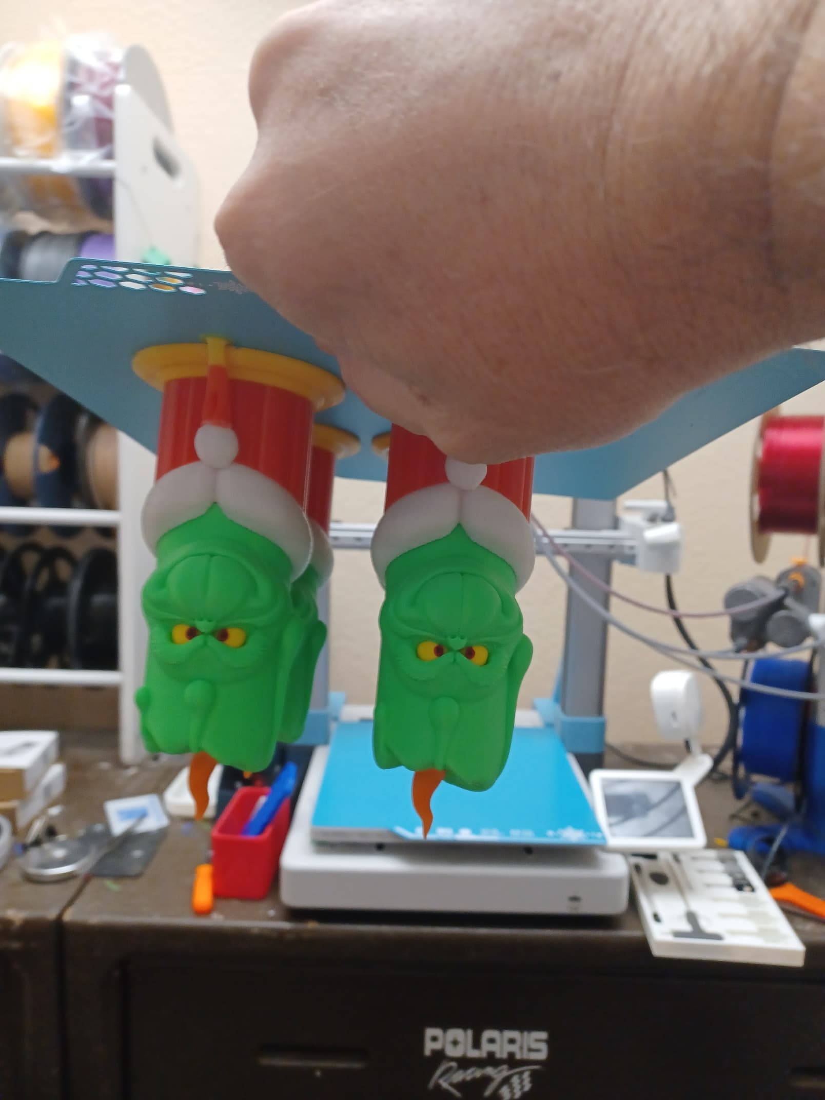

clean your plate properly and it will stick to it instead of dragging around the plate accumulating more plastic… i have had my A1 since launch (i even did the bed replacement myself for the recall) i have never had a blob issue… HOT WATER AND DAWN DISH SOAP IS ALL YOU NEED THEN DRY WITH A PAPER TOWEL NOTHING ELSE NO ALCOHOL… NOTHING!! ITS CLEAN UNTIL YOU TOUCH IT AGAIN WITH YOUR HANDS

Im a 6’3" tall guy at 220lbs I have had my A1 since launch and never had an issue with a latch if my giant hands can deal with that so called tiny piece of wire, then anyone should be able to. I think many of you are just reckless and impatient. I read the wikis when i had to do maintenance not just start tearing into stuff I didnt know about. I even did the bed replacement myself on the recall and mine still runs like new. Only had 1 small clog from not calibrating my filament the first time i tried the .2mm hotend but never had another… easiest machine there is
