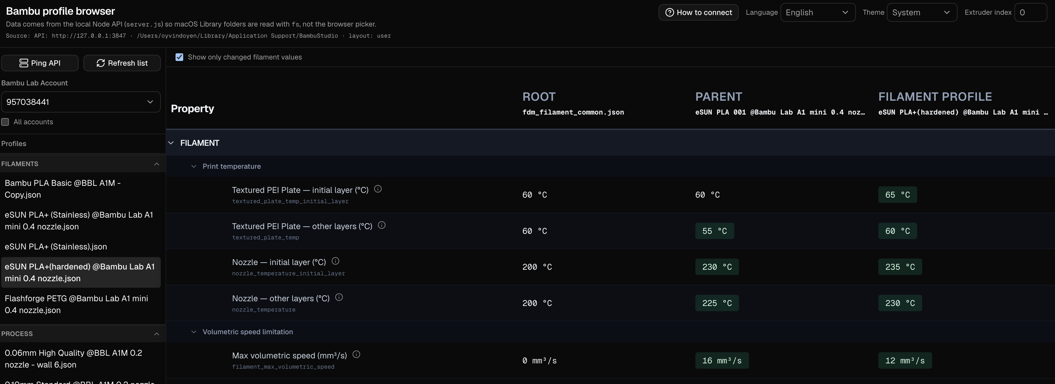

Web App for viewing changes made to custom Filament & Process profiles
When I save changes to profiles or filaments I cannot return to the prevoius value or ever again see what it was. That’s annoying.
If you are very non-tecnical, skip straight to ‘Solution for very non-tecnical users‘ below…
I’ve been working on a small local tool called Bambu browser that reads Bambu Studio’s on-disk JSON / preset data (machines, processes, filaments, inheritance between profiles) and shows it in a clean web UI. Nothing leaves your machine: you run everything yourself on localhost.
I think it could be useful for people who live in presets, inheritance chains, and “why does this profile look like that?”. This may be aimed at technical users. You need Node.js, two terminal processes (a tiny local API + the Next.js dev server), git (source control) and ideally you’re comfortable cloning a repo and reading a README.
Why a local API? Browsers can’t reliably read folders like macOS ~/Library/Application Support/BambuStudio, and the File System Access picker has its own limits. A small read-only Node HTTP server reads Studio’s data directory and the UI talks to it over 127.0.0.1 — that’s the dependable path today.
Clone the repo here: GitHub - oyvindo/bambu-browser: Track custom filaments and proceses. Compare base · GitHub

I have also published the app on Vercel: https://bambu-browser.vercel.app/.
Connect the folder C:\Users\\AppData\Roaming\BambuStudio
For mac users you still have to clone the project from github to run the local api to access your private folders and may as well run the app localy.
(as a mac-workarounds you may copy ‘/Users//Library/Application Support/BambuStudio’ to a location where chrome has access. Then the vercel app is all you need. Just point to that folder.)

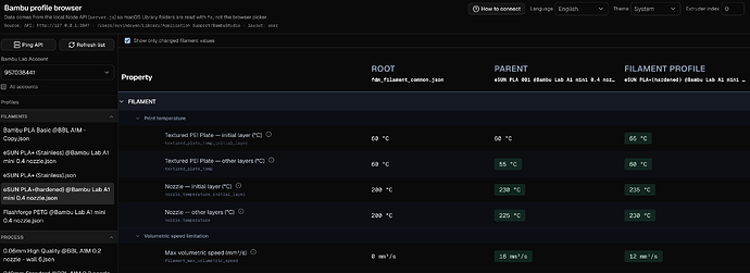

Example process:
Example Filament:

I have made some updates…
The app now includes an editor for your (custom) filaments and profilers. The idéa is that you open the json, paste it into some ai with information about which brand, printer, nozle etc. ask for a better configuration. Validitet the answer, ask for the reasoning for event setting. Paste it back into the editor. Validat and save. Restart bambu studio to Get the update.
I wrapped the app using Electron and now publish desktop apps for both Mac and Windows. Download here: Release v0.1.1 · oyvindo/bambu-browser · GitHub
You will get a security warning when you start the application. Please take a look at the readme file here: bambu-browser/README.md at main · oyvindo/bambu-browser · GitHub on How to handle, espesially on Mac. It is no big deal, but you need to trust my Code.
