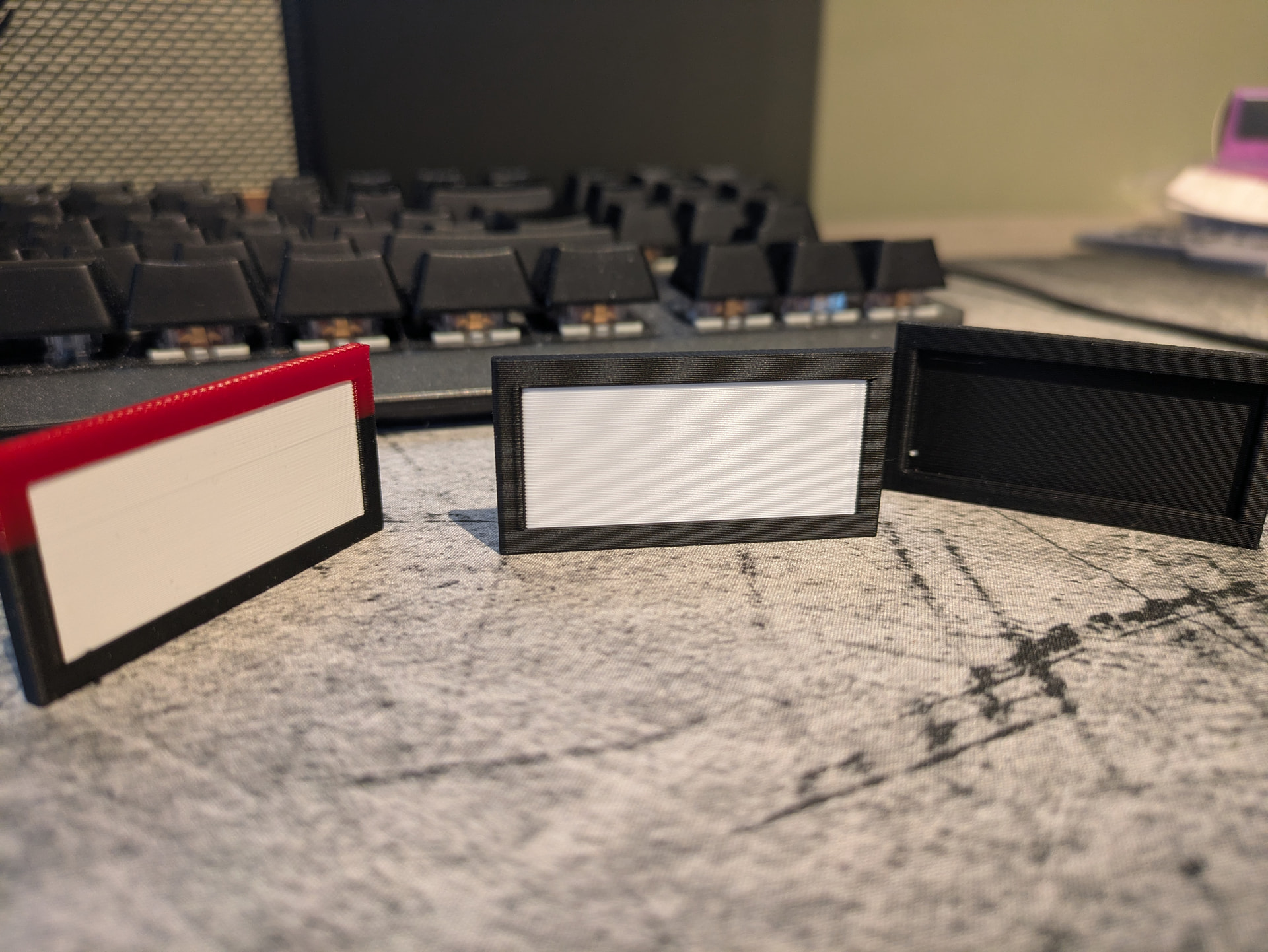

So I started having some extrusion issues on the X2D aux extruder, where it seemed to start to high. (mentioned in another post), that seems to either stem from a error in the nozzle offset sensor, or the extruder itself.
Fine, I bought a printer day one, I am not suprised there was some teething issues, no stranger to that. (its the grey/white in the picture)
Redoing offset calibration fixed it somwhat for one print (just not as bad), but as soon as it did run it again (the slicer were set to auto calibrate) the issues reapeared (and no subsequen calibration seemed to fix it). (it seem to start the next layer to high.
Did the regular recalibrate, replace nozzle, swap to a known good filament (dried ofc), same issue.

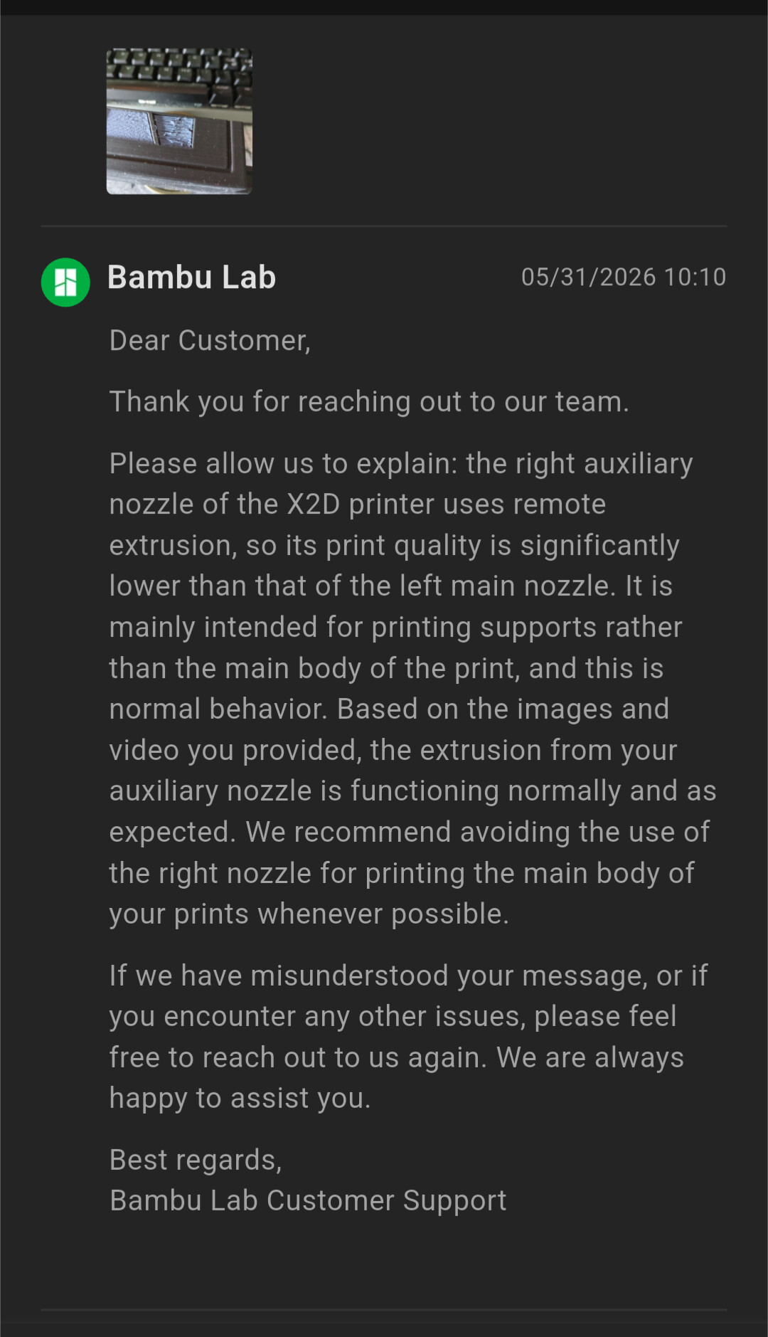

Fine, I reach out to Bambu support, thinking it might be bad sensor, or such, thinking they either have a fix or just going to replace the sensor itself. A bit annoying, but hey.
Nope, this mess is the “expected quality” of the aux nozzle according to Bambu support.
We all know its not as precice as the main nozzle, but this is just stupid to claim..

Can you show a screen with Bambu support answer please? Because I simply cannot believe they answered in such manner. As you mentioned earlier, it’s a mess on this photo, and this has nothing to with “expected quality”.
that is UTTERLY ridiculous. that is not normal extrusion.
Thank you. That’s absolutely hillarious, I’m speechless. This is what you can find on offical Bambu page:
“In actual testing, print quality from the auxiliary nozzle is slightly lower than that of the main nozzle.”
Slightly lower… It looks as massive under-extrusion, what the filament type are you using for both colors? Also, please share a model.
Tried several, both bambu and non bambu.
I do think its related to the nozzle offset sensor, as it ocationally gets more or less “fixed” after the calibration, but it dont seem to stick.

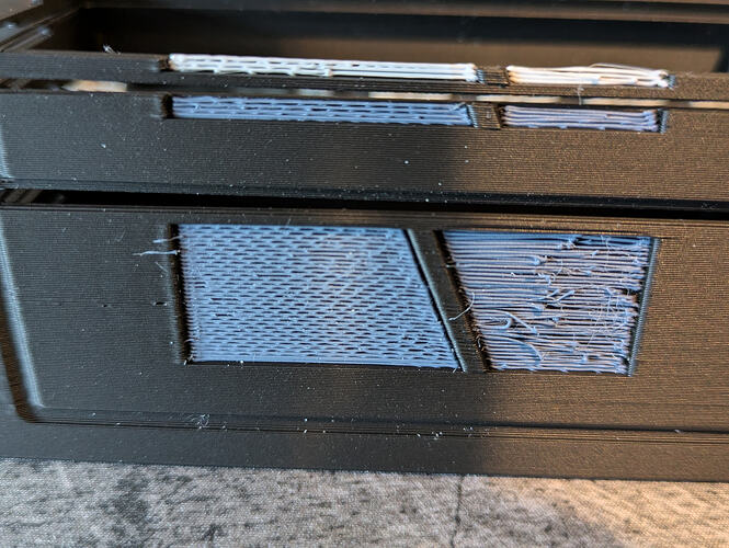

Luckily my aux nozzle is just messy - leaves crumbles wisps and poops all over in the back where it shouldn’t.
I will suggest that you do manual tuning of PA, flow, and retraction length on filament going thru your aux, i’ve seen tested PA values from 0.05x all the way to 0.44x, it’s way more wild to try to get good quality out of. Make it do supports at 0 distance and youll be happy

I did find the solution, it was a setting that had mysteriously changed, and coupled with the largew delay in the bowden system the nozzle did not prime enough.
Bambus answer is still bonkers, but glad it was not hardware.
Glad to hear. Can you share with setting are you reffering to? It can help someone else. And yeah, Bambu answer is tragic.
I dunno, it was a very embarassing brainfart….
But basically the profile I had downloaded disabled the prime tower (on a X2D spesific multicoulour print, and since my aux nozzle dont start to extrude anything before its atleast one full line “done” in on the prime tower, it had tthese results.
That setting carried forward into the next test prints and for some stupid reason on my part i did not connect the dots. (This is my first multi-nozzle machine.)
