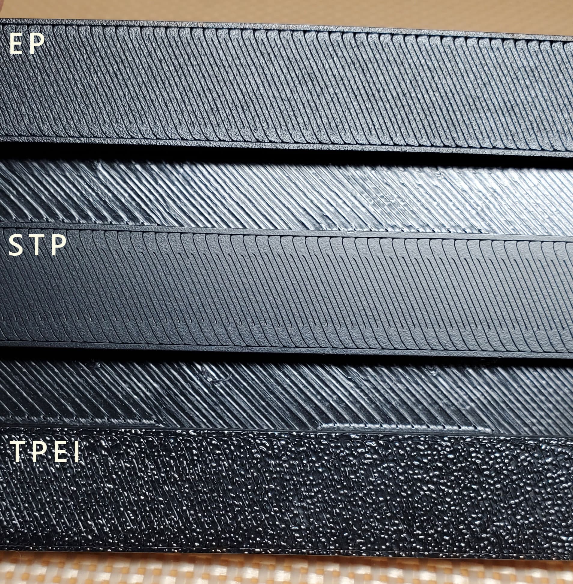

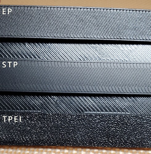

So I did a deeper dive into plate surface finishes. Or maybe dove off the deep end… you decide! :slight_smile:
Printed the same piece on the Engineering plate that I already had from the textured and Super Tack Pro plates. Same roll of PETG HF, same nozzle size and slicing settings. As before, .6mm nozzle, .62 line width.
STP detail
Engineering detail
Textured PEI detail
So indeed the Engineering plate has a bit more texture to it. However the biggest difference isn’t visual… it’s the freakin’ glue [stick} on the EP. The STP example came off the plate as you see it. The EP sample looked clean enough… 'till I went to wash it off and then you can really feel the glue. Hot water and dish soap gets it off, as does alcohol, but what a pain.

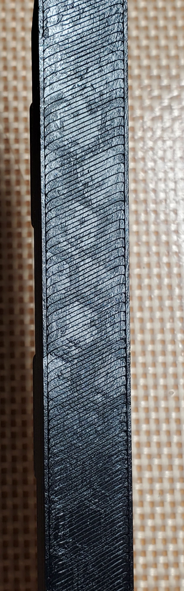

Also, if you print over old glue [stick] that has been printed on already, you’re likely to end up with permanent marks on the bottom surface. The pictures below are of the same piece as the others but I printed it before washing off the plate (I did apply a bit of fresh glue on top of the old). The last thing I printed on it was a filament spool with hexagonal pattern walls (in PC translucent). You can see the pattern… and I can’t get it off the surface of this piece, not with super hot water/soap/scrubbing nor 91% iso. It’s kinda baked-in… subtle but fairly obvious. Perhaps the phenomenon could be used for creative effect!

this looks like that the plastic was extruded on top of the old, stacked glue. Better spread out the glue before next print by using scrapers and ipa and a little bit of hot water:
this is my previous attempt and it’s working pretty well for me.
A glue stick spreader is a good idea. I tried with an IPA-soaked cloth, and a sponge… messy and couldn’t get it very even. Mostly I’m just spreading out my prints, then washing. Tried to get lazy this time, and a cheap lesson learned. My hot water is ~100 yards/meters away in the main house, which currently requires crossing a frozen tundra… not very motivating. :slight_smile:
I think heating up the plate a bit in the printer first would also help spread out the glue.
Wonder if one of those rubber scrapers for spreading ink on silk screen prints would work well. Nice stiff rubber edge… might have some of those around here somewhere, will have to check!
