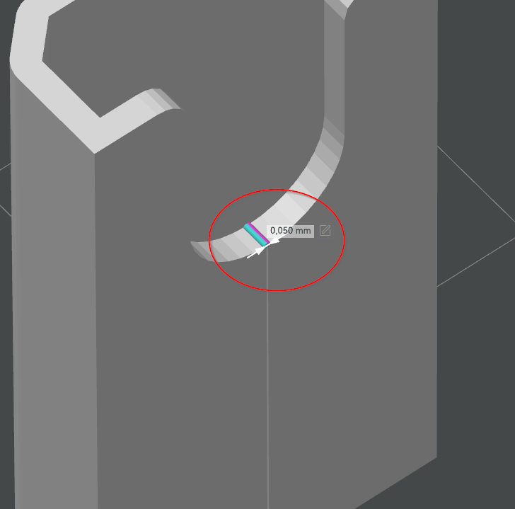

  1. There is a small gap in the front of the STL with just 0.05mm width. The slicer just removed it, it is too small for a 0.4mm nozzle.

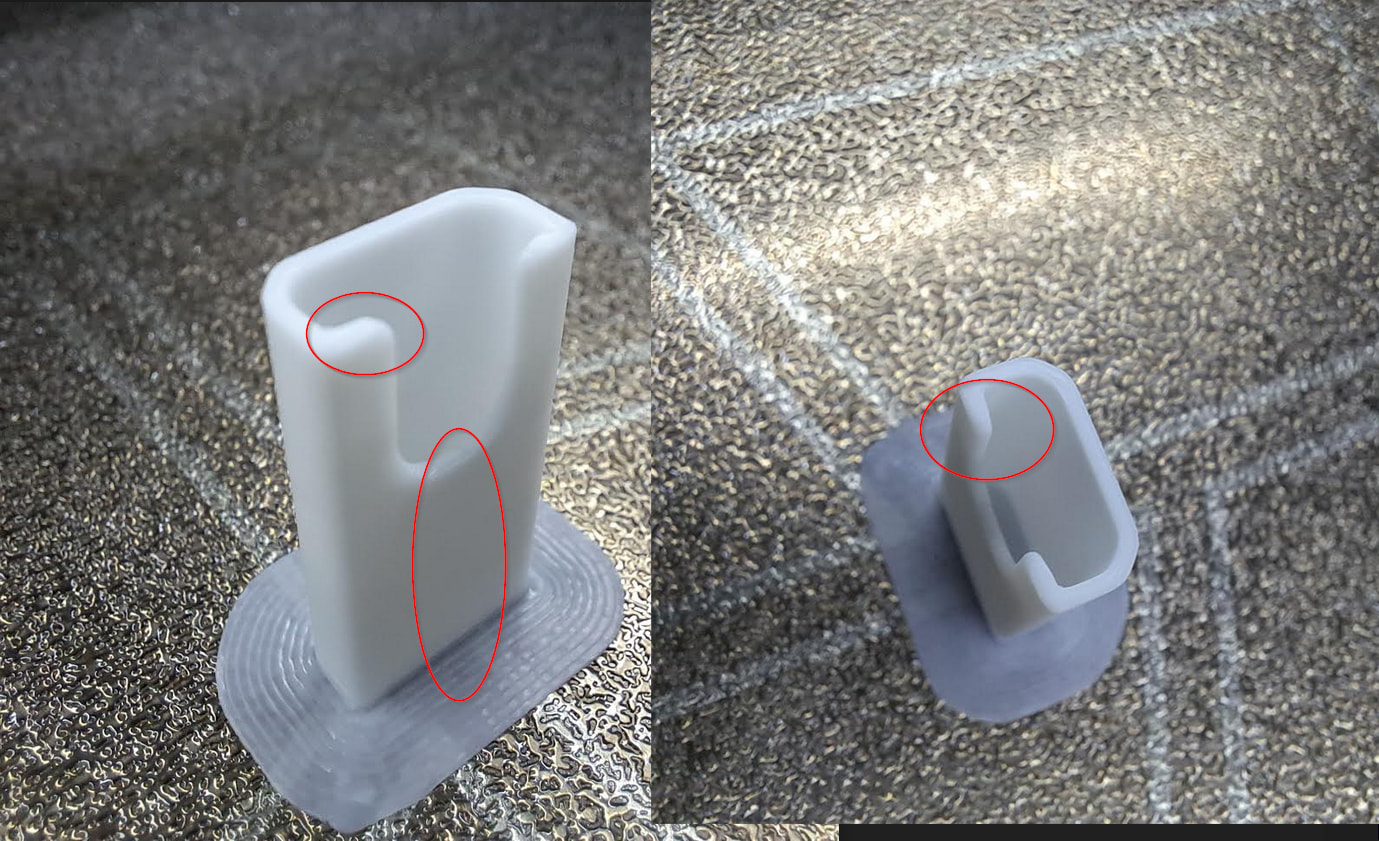

Thank you all. Some extra info:
Nozzle: 0.4mm
Filament: Creality PETG (works perfectly on larger parts)
Filament profile: Generic PETG (works perfectly on larger parts)
In the picture I used a 5 layer Raft. I tried to use a brim and the printer could not hold the part in place, the part inclined and dropped. EDIT: I now used a brim with ZERO gap and it holds.

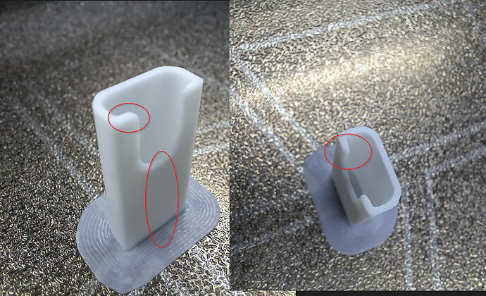

I Managed to print it perfectly now using the following changes:
Layer height: 0.16mm high quality
Line width: ALL 0.4mm
Slice gap closing radius: I added an extra zero so: 0.0049 (for the gap to appear)
Resolution: : I added an extra zero so: 0.0012
Brim type: outer brim
Brim width: 10mm
Brim – object gap: 0mm
Spiral vase: CHECK (I think this made the magic) there is no seam now to create the strange cylinder. As a result of checking the spiral vase the following parameters changed automatically:

Using vase mode eliminates the seam, but the single-loop walls are 0.4 mm thick instead of the 0.82 mm design thickness.
Quality→Seam→ Seam Position→ Nearest or Back would move the seam to a corner where it could be unnoticeable. Then the model could print in Regular mode with two wall loops and be dimensionally accurate.
If the print works and you are happy with it, that’s all that matters.
