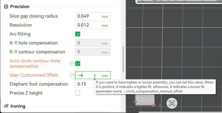

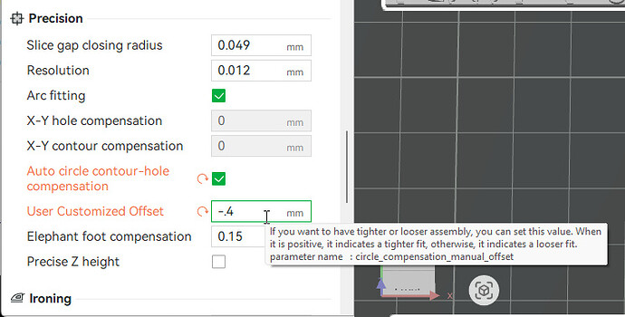

i want to make a hole size, on printing, slightly smaller than what is in the STL file.
bambu has the CUSTOMIZED HOLE OFFSET
it says that if the value is positive, it is a tighter fit; but if i make the number positive, the hole SEEMS to be larger (in the bambu studio).
what is the correct way to enter values here? Negative, or positive, to make the hole smaller? thanks

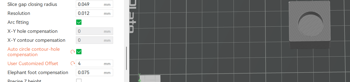

Before and after images using 4 mm (after slicing)

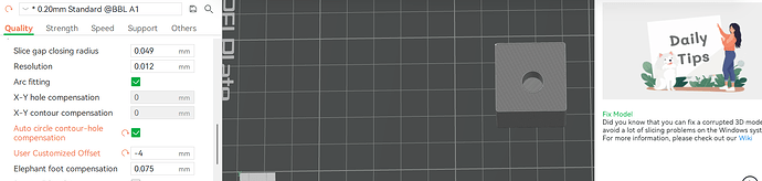

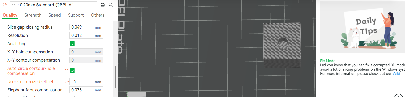

This 3rd image is -4 mm again after slicing
thanks -
SO, the verbage is not coreect; NEGATIVE makes tighter fit, positive makes looser fit.

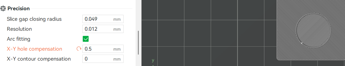

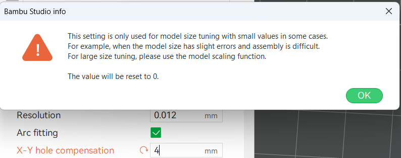

i used .5 and it was corrected to 0.5 ,but still loser
@aPrinterInTheHills you may be better of using this setting , althhough it is still positive is looser negative tighter

i actually did the drill gauge, with (-0.4) setting, and then drilled each hole (basically just fine tuned it) with accurate drill bit, and i now have accurate drill gauge.
BUT, i will also try reprinting (will make a 5-hole test gauge) to see how accurate this can get, using the X-Y hole, and see what happens
