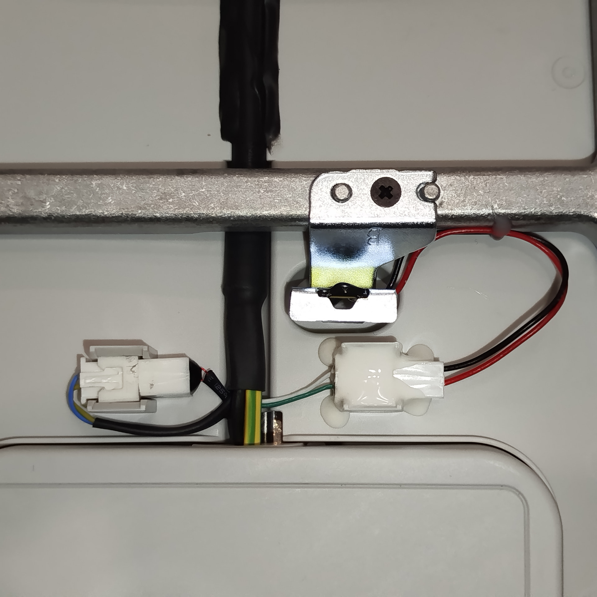

When printing on a Bambu Lab A1 printer, a critical error occurs with the code 0300-1B00-0001-0003.
The screen displays: “The acceleration sensor of the heating table has detected an unexpected continuous force. The sensor may be stuck or the analog frontend may be faulty.”

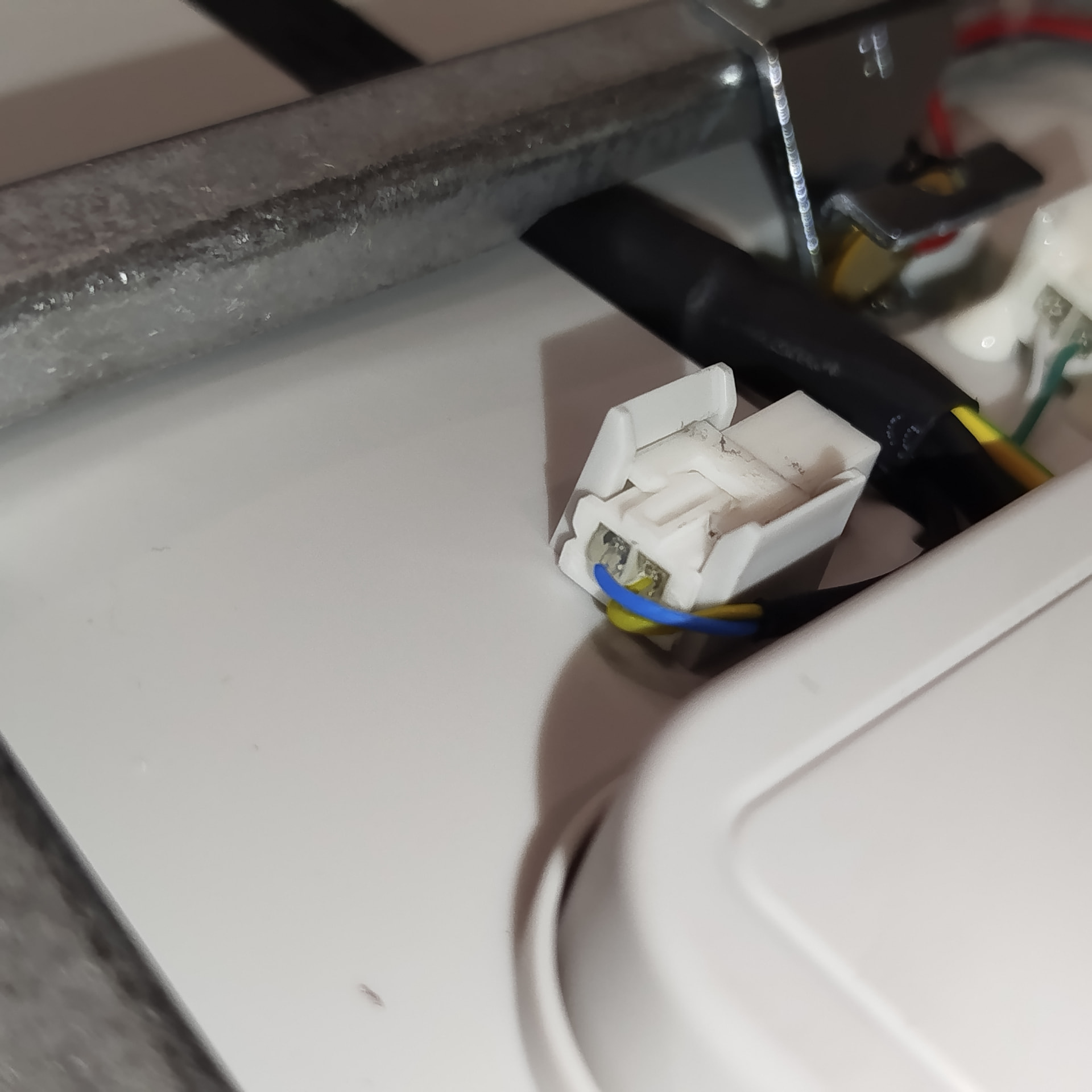

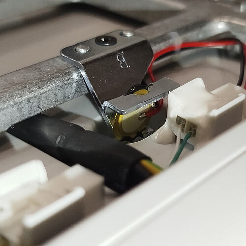

We have checked the heating table sensor according to the instructions. No visual damage, breaks, or defects were found. The sensor is intact, and the connectors and cable are in good condition.
We have inspected everything based on the first error code (HMS_0300-1B00-0001-0001). Please let us know what to do next, and we will proceed to the next step.
Perhaps you have a failed sensor? Try unplugging it and see if the same code remains.
I’d order a replacement just in case.
