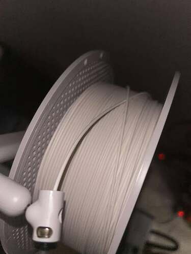

Hello, just today was my first day with 3D printer and it is Bambu Lab A1. I have only one issue with it so far, the filament gets stuck under itself like in the picture. If i don’t manually spin the filament it gets stuck like this every time and i get error that filament is tangled. How can i avoid this so i don’t need to stand by the printer and spin the wheel? I didn’t find any solution for A1, only for A1 mini.
Unload the filament, and pull the free end from under the turn of filament that’s trapping it. Then re-load the filament into the printer.
It’s a Good Idea to have some sort of clip to stop the free end accidentally getting tucked under another turn of filament on the reel like this.
