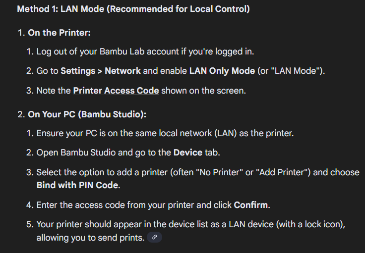

You can also try this mode if you do not have an account but not sure if this soution is outdated:
Another method would be loading your print file onto the micro-sd and plugging in the micro-sd to your printer.
If you have wireless internet connection at home but your pc does not and you would like your pc to have wireless connection you can try and purchase a wireless usb dongle. Don’t need to get a fancy one, plugging in the usb dongle will let your PC have access to wireless internet (as long as you have a wireless router).
You don’t necessarily need wifi for your pc to be connected to your printer. Your printer can be connected via wifi to your router and your PC via LAN cable. Try following the steps below to connect your printer to your bambu lab account:
