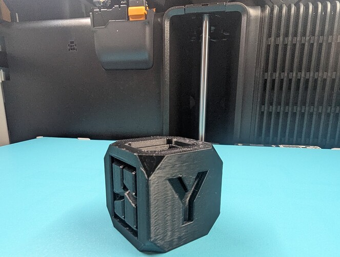

Hello, so i am having some issues while printing Bambulab Black ABS on my H2D. The prints finish without warping but the walls are not pretty and full of what i think is ringing or ghosting.
Before we get into my print settings, drying etc. I want to add that i had no issues when printing PLA, PETG and Nylon-CF from different vendors including Bambu Lab before trying the ABS spool.
This is my first spool of ABS ever, and i dred it in the AMS HT at 80 degrees for 8 hours, because my first ever print clearly indicated that the fillament was wet.
But all the following prints after the drying has this ringing issue as shown in the pictures including my print settings

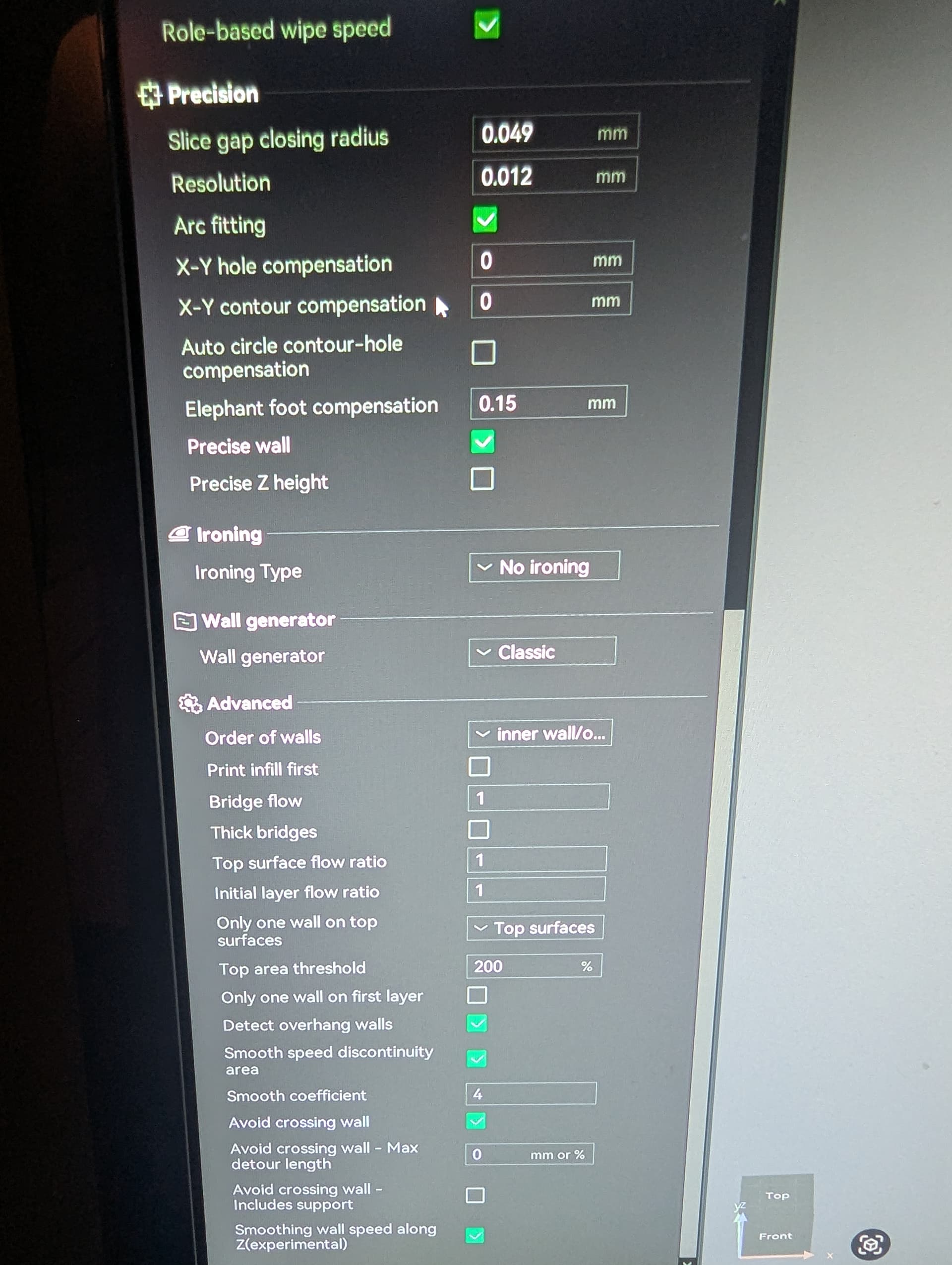

Settings & Preparation summary:
  1. Dried in AMS HT 80 Degrees celsius for 8h
  2. Bambulab ABS default fillament profile with 65 degree chamber temperature.
    2.1 Tried both with and without
    “Slow down for better layer cooling”
    2.2 Tried lowering the print temp by 5 degrees,
    With no visual impact on the finished print

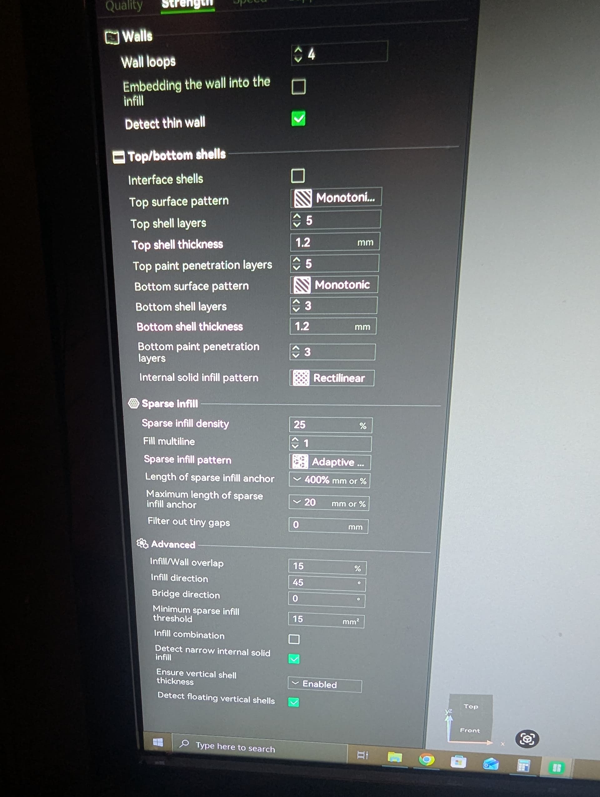

  3. The full print settings are show in the pictures. But the general settings for the prints i’ve tried are
    3.1 Precise walls enabled
    3.2 Avoid crossing walls
    3.3 Inner/outer/inner wall order
    3.4 Four walls
    3.5 25% Adaptive cubic infill

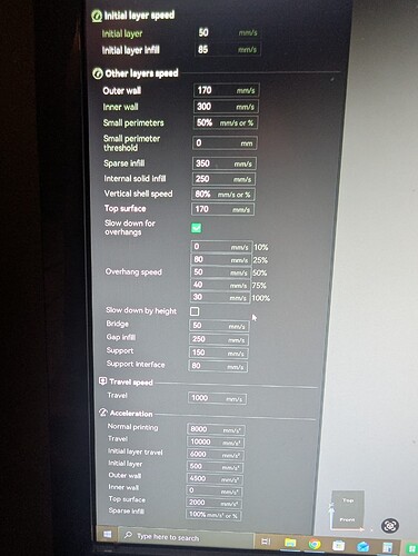

Things that might help:
  • printing walls faster
  • enabling “don’t slow down outer walls” (I believe from the top of my head this also overrides the two smoothing features on outer walls but I’m really not sure, otherwise also try playing with the two smoothing options on the quality tab)

I have now gone through a rabbit hole and managed to make the surface finish way better. I am not sure however if i have fixed the actual issue. But i will go through my findings here. And hopefully any other people with the same issue can try my steps
I also re tightened the X and Y axis belts with no changes to the ABS print quality. And i also tested PLA and PETG which printed perfectly.
These pictures show the before and after. (Its hard to take pictures showing the results, but belive me the changes are huge)

STEP THREE: MAJOR VISUAL IMPACT
When doing the max flow calibration i noticed that from 5mm2 to 25mm2 i saw none of the visual artifacts i was used to.
But this calibration has almost no changes in acceleration and sharp corners. So from this i deducted that the acceleration settings must be whats causing the majority of the artefacts.
And behold it was. After keeping the original print settings as shown at the start of this forum post with the new nozzle and calibrated filament. Reducing the acceleration alot “fixed” the rest of the problem.
Outer Wall down from 5000 to 2500mm acceleration
Inner wall down from 8000 to 6000mm acceleration
My theory is that the viscosity of the Bambulab ABS filament cannot handle the jerk and acceleration as good as the PLA and PETG i have tested.
CONCLUSION:
I don’t want to use more time troubleshooting. The result is not perfect but good enough for me.
But reducing the acceleration not speed is what had the biggest impact on the quality.
