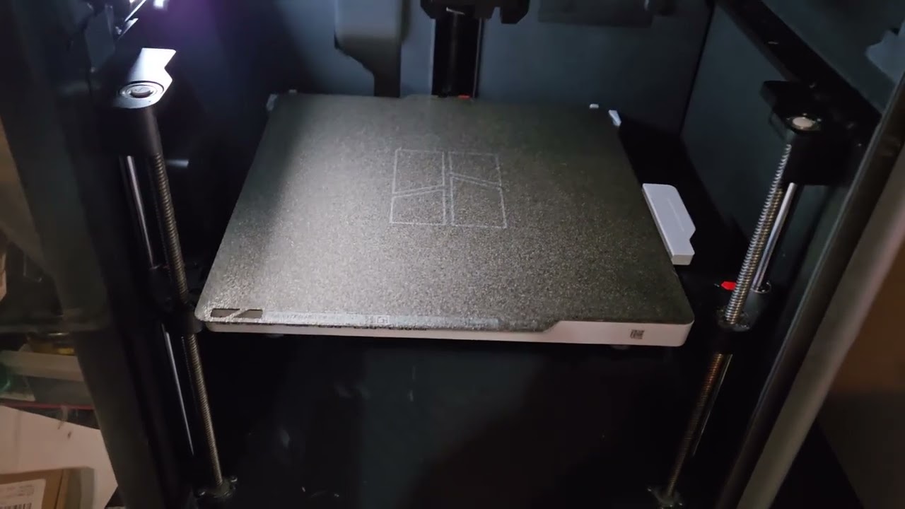

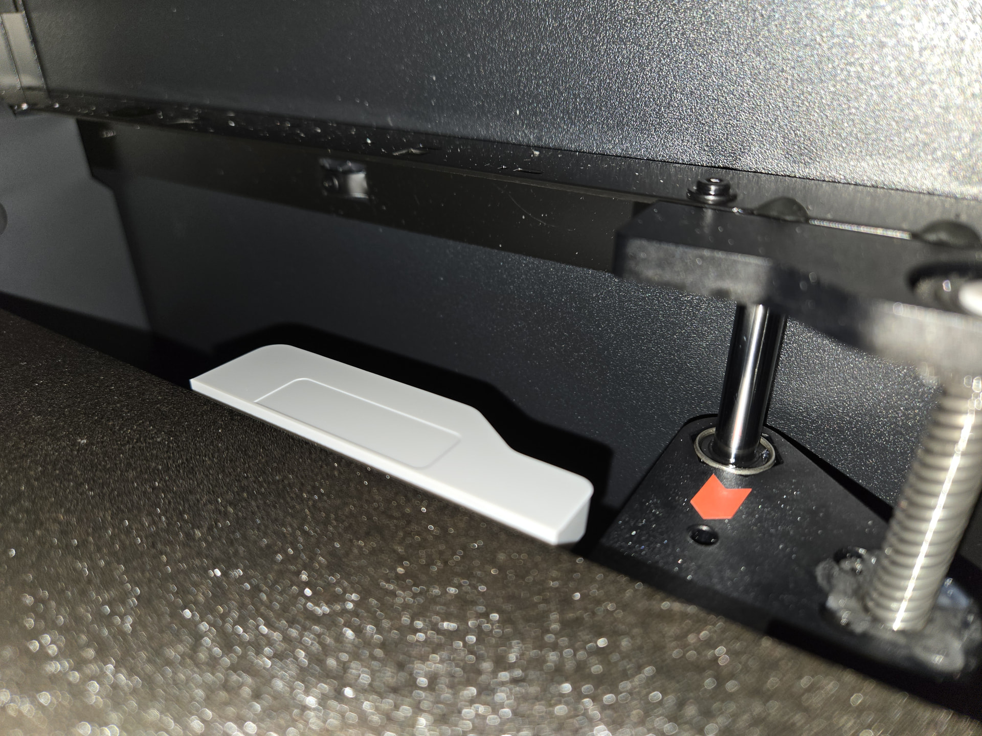

Here’s some images of my machine in case anyone notices anything out of the ordinary?

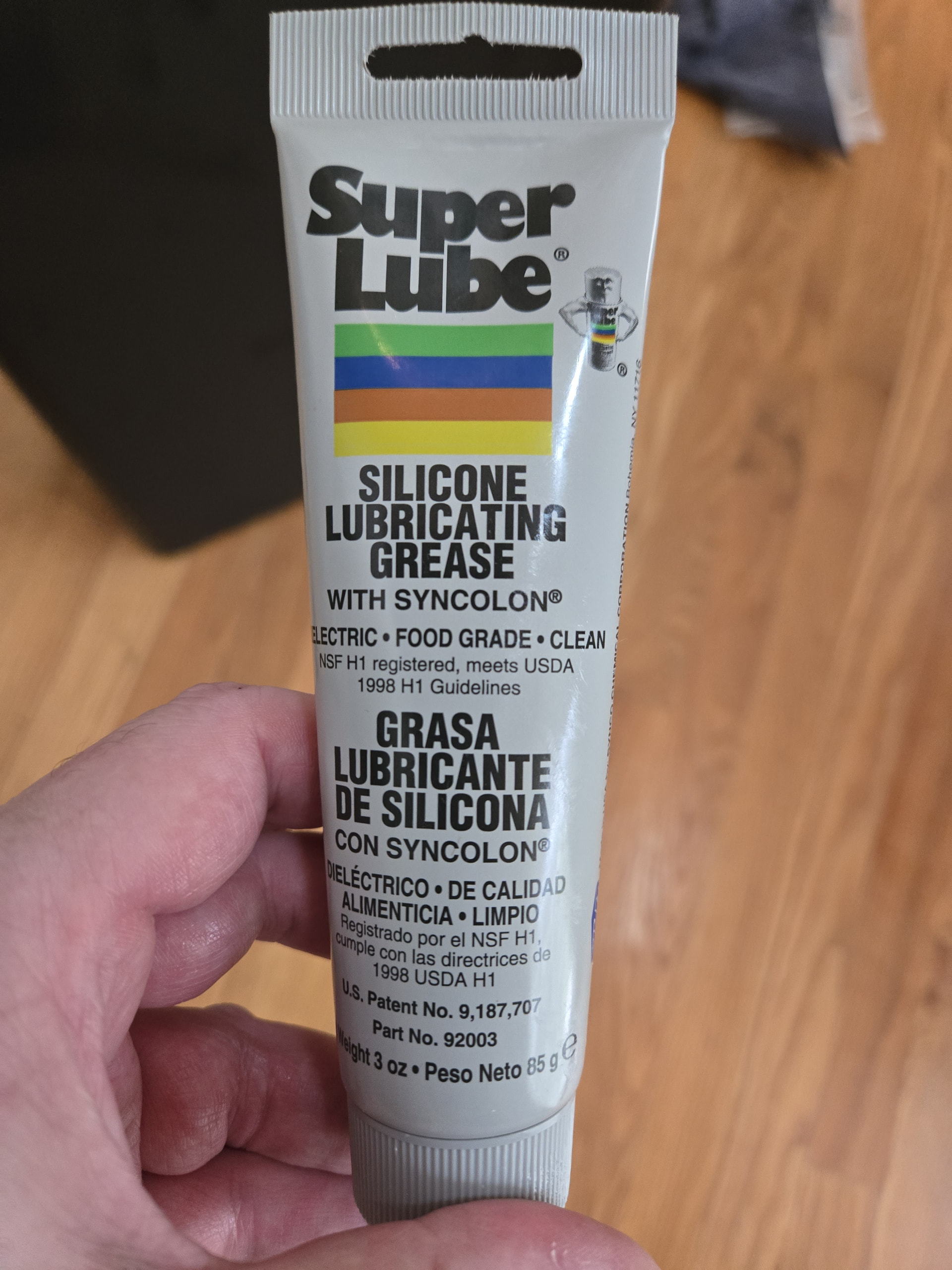

What are you using to lube your screws?

I’m using Super Lube Silicone grease

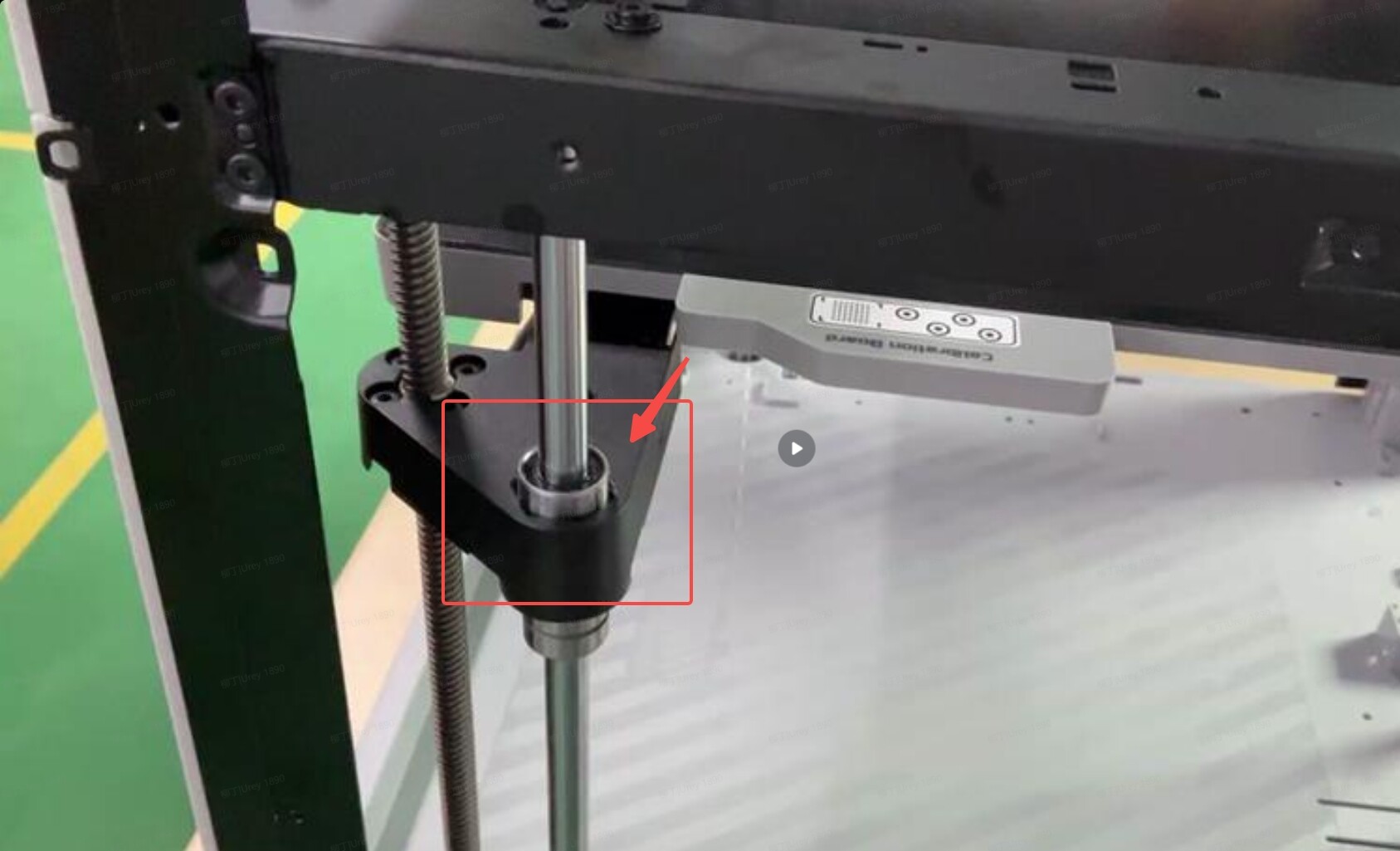

Check this post regarding remedy for bearing rod popping out of the bottom of the P1 series. This is a quick check and quick fix if that is in fact what is causing this: Solution: The build plate is not placed properly

Thanks. My bearings look like they’re in place OK. I might have to get that stethoscope. This is really annoying. I also put in a ticket with Bambu Lab so we’ll see what they say as well.
Thanks for the clear photos. Those bearings are exactly in place so that’s at least one theory put to rest.

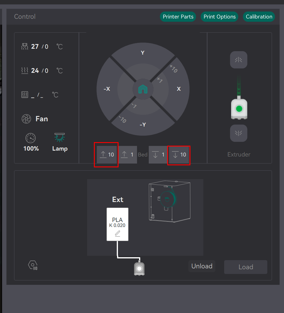

One question that just occurred to me and was not evident in the video. Does this grinding noise occur at the beginning of travel, end of travel or all heights? Have you tried to manually move the bed height using the control panel and can you reproduce the noise? I ask because the control panel has an annoying quirk in that it does not move the Z axis uniformly, it does it in segments forcing the user to keep tapping the panel. However, in this case it may be useful. Alternatively, you can do this from the slicer which might be more convenient as mouse clicks seem to register more radipdly and more immediately than the panel button presses, but that could be more of a perception on my part.

The lube you are using is good and the rods look like they are in good condition.

It makes the noise throughout the entirety of travel.
But I did try with the bambu studio controls and it did not seem to make the noise. Weird.

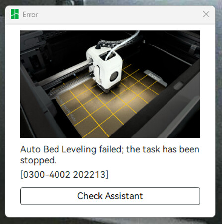

I ran a calibration but it failed the “bed leveling”.

what about one of the Z-axis Linear Bearings going bad and dragging? Not enough to realy skew the bed but cause resistance?
If you look earlier in this thread, I checked that and provided photos. They all look OK. Despite that, I did do the upside down flip, move bed all the way to top of chamber, then pushed down with some pressure to make sure they were all in place.
