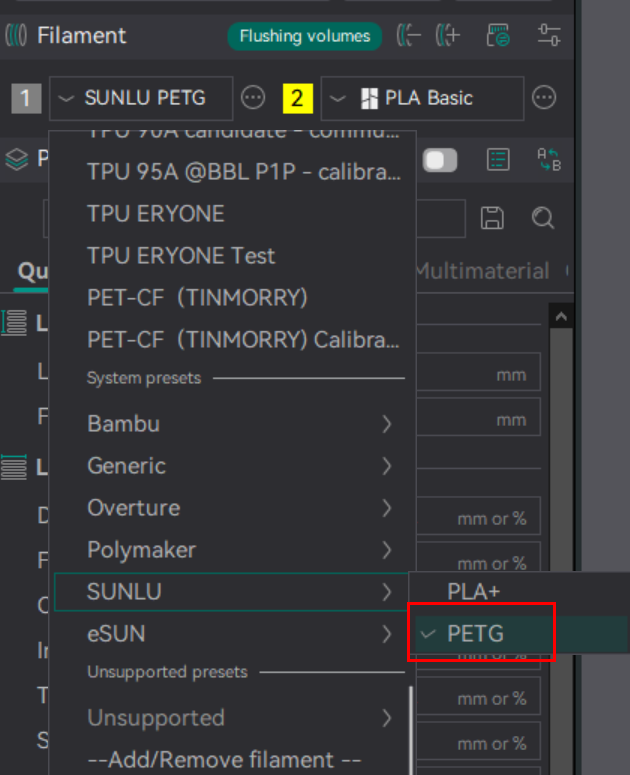

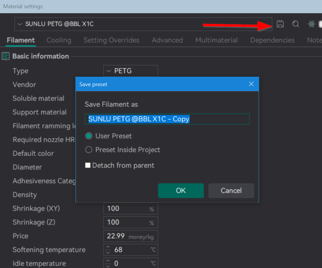

Right now with my Sunlu or Jayo HS PETG, I tell the printer its Bambu HF PETG. Is there a way I can have the printer save the Bambu HF settings under the name of Sunlu HS PETG or Jayo HS PETG. This would be so I could know exactly what I have in the AMSs though it will be the Bambu HF PETG settings. Or is this something I need to do in Bambu Studio?

If you need to identify the filament for AMS purposes, the slicer makes this relatively trivial.
In Orca slicer there is also an option to merge to profiles. I haven’t had a reason to use this on my Bambu Machine since I don’t have an AMS, but I have used it on my Creality CFS which is the same function as the AMS. The merge function essentially renames one profile for another.
