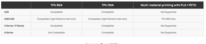

Hi, I am new to Using tpu I have ordered some and I do not know if there is anything that I need to know about using TPU on my P2S I also have an a1 Mini that I can print on.
Do I need to use my P2S or A1 Mini?

Read the store info and follow to the wiki pages
To augment what @Neiljt shared, you can take a look at TPU Printing Guide | Bambu Lab Wiki to help you get started.

I print TPU on my Mini. It handles it quite well. I’ve had zero issues and each print turned out spot on. It’s very simple. I run a PTFE out the back of one of my AMS-HT units that the TPU is in. Feed the TPU through the PTFE to the Mini and select the appropriate filament on the screen. Do the Studio thing and send it to the printer. It just works. Phenomenal printer.
