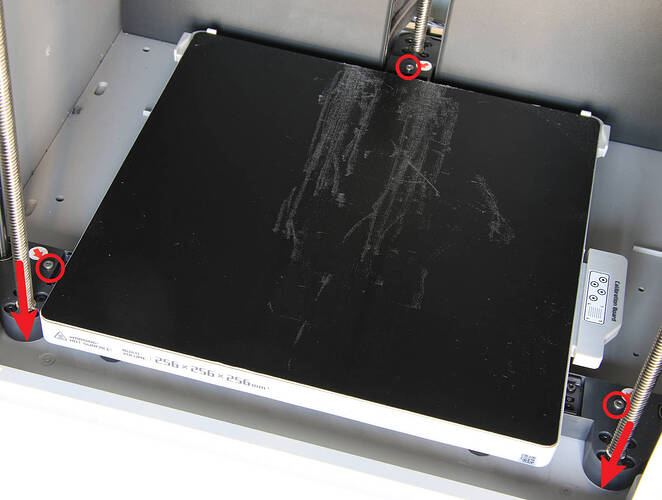

Hey guys,
I need to change the z belt on my p1s machine , i bought it not new. now i am looking which size the bed secure screws are. I also was ordering an screw kit for the p1s machine , But i cant figuring out which screws they are.
From my friend looking diffrent , like from the Bambu Instructions. Which screws are now the right ones? And which size ?

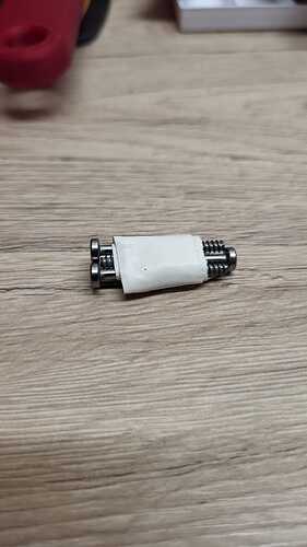

These are the correct screws for securing the bed.
They have the course plastic thread and are 28mm long.
The other screws you showed are for the AMS buffer. They come in the spare parts kit (M3-23). The wiki has the incorrect picture. @SupportAssistant
Ahhh okay the wiki showing the wrong picture……….man man man
The tutorial (wiki) is wrong.

Apologies for the incorrect image. We have updated the wiki with the right image.
