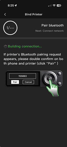

I have a P1S that will not bind after a factory reset. I am selling one of my P1S’ and changed my mind which one I was selling after factory reseting it. Now trying to Bind it back to my account it gets stuck on the bluetooth connection part. The Building Connection just spins and spins and spins.
I have tried many times. I have tried pairing to nearby device and selecting it. It picks up the device, but then never connects. I have tried factory reseting again. still nothing.

Finally got the SD Card method to work. With downloading the file in the guide. I had tried it multiple times, but had trouble getting the file format correct on my Mac.
