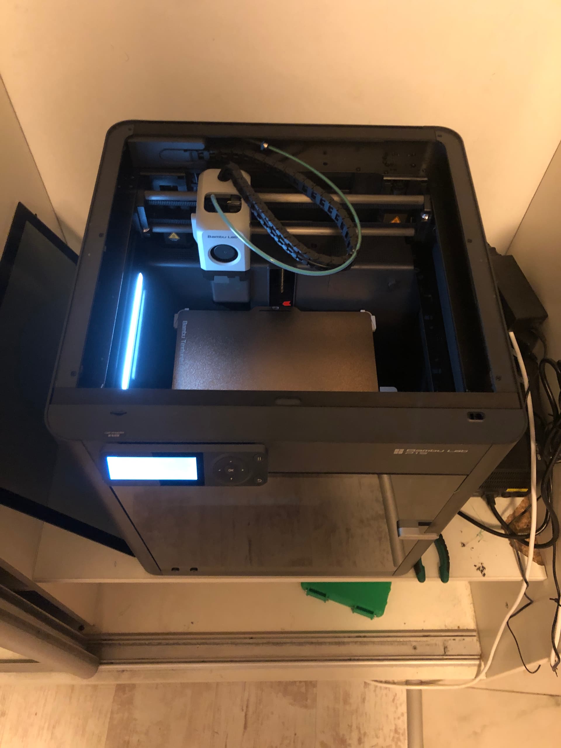

My situation looks something like this. I have the P1S machine and print with original Bambu PLA Basic filaments. Nearly 660 hours printed on this machine. And one day I started to get clogs. The problem is after cleaning the clog it’s again clogged. The main mystery is that nothing was changed in the operational environment. After the first event of clogging, now I’m getting clogs all the time at the 5-20 layer of print.

Could you please share what is the temperature of the environment where you are using the printer?

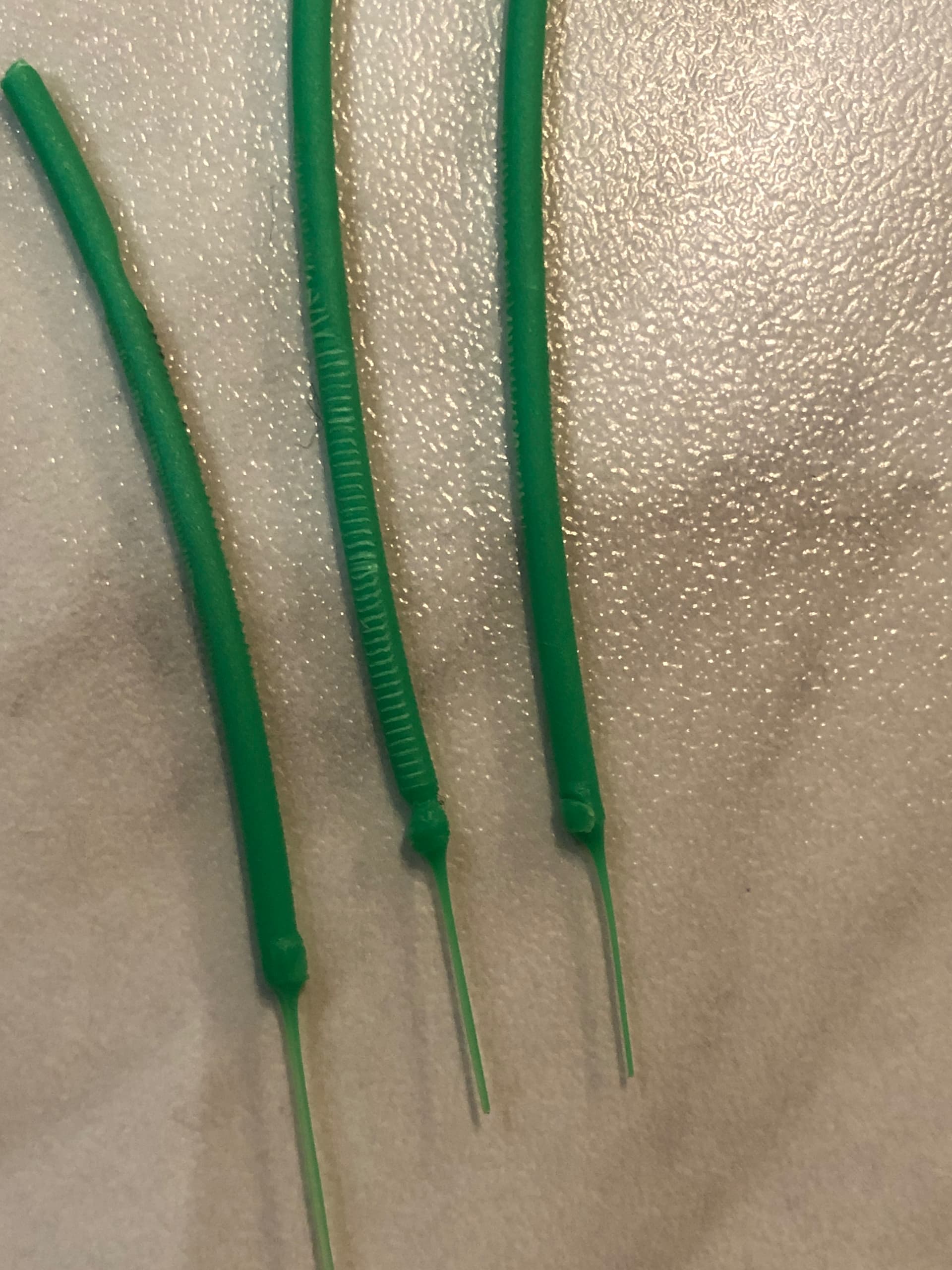

Do you have any pictures from the unclogging procedures? Is the filament deforming in the extruder?
Have you tried printing with the front door open and/or top cover removed? This could help confirm if it is related to heat creep or not.

  2. Pictures attached
  3. I’ve print always without cover removed. But that’s not important. Important that it stopped printing with the same conditions like I said before.

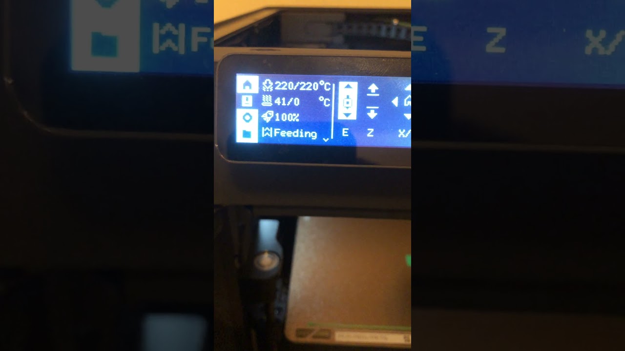

Also videos:
Also sometimes even after the cleaning of the clog, extruder skipping steps.
Have you done a cold pull?
Could it be a filament diameter issue ? the filament in the middle looks like it is being stretched and snagging/slipping ( lines ) as its being fed through the extruder mechanism
I’d second @Neiljt here in that a check of the filament diameter could be helpful.
From the Vid’s, I can not really spot the issue unfortunately.
The Cold Pull’s look clean although there is some extruder abrasion visible on the upper left (so maybe some new residue in the extruder, which may of course also travel with the filament while reducing extruder grip). Did you insert the filament at 220°C or was it colder? It’ll only really be effective if fully melted before being allowed to cool prior to pulling. I have only really ever had success with the hex key method. Usually, I do that 2-3 times in a row.

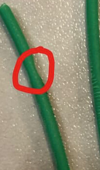

Did you closely inspect your extruder gears? Did you by chance take pic’s?
The reason why I am asking is that you very clearly have extruder filament abrasion:
Also, I assume the first vid is to illustrate the success of a “simple cold pull”? The “simple cold pull” never properly worked for me. It always just temporarily freed the nozzle but it was never long before it clogged again. The only method that reliably works for me is the hot hex key method | Bambu Lab Wiki if I do it a few times in a row. And then check/clean-out the extruder gears.

I see your red circle, that’s rathe abnormal result that regular. There are also a lot of cases when extruder motor skips steps. I try a lot of hot / cold pulled and even changed the nozzle. Sometimes event, when the stars and planets set up in right order, I could print full “Benchy”, but it’s so rare.

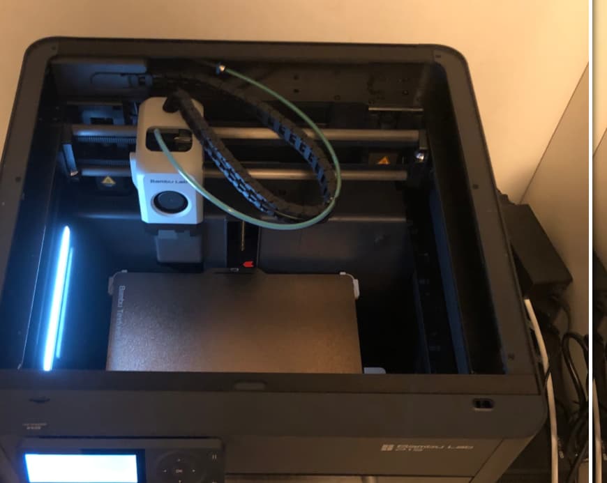

Considering the details provided, and the picture that shows the filament being deformed, there is a high chance that it could be caused by heat creep.
If this picture shows the filament when the printer was working with the top cover removed, then the problem might be different. Is this problem occurring with other filament, like PETG?
In the picture shared, the printer seems to also use a different PTFE tube. If the internal diameter is smaller than the original, the filament path could be constrained and cause some problems of extruding.

Hi. Yes, that’s new PTFE tube like I said in previous messages if you read them. This is original PTFE tube from Bambu. No, printer not working with lid opened. Lid was opened all the time. Will open the ticket with support team. Thank you.

The PTFE tube color in the picture is slightly different from the regular white, so I was thinking it could be an aftermarket variant. Please excuse the misunderstanding.

Are you kidding me? That’s the grey tube form your store - PTFE Tubes . You could select grey color.
