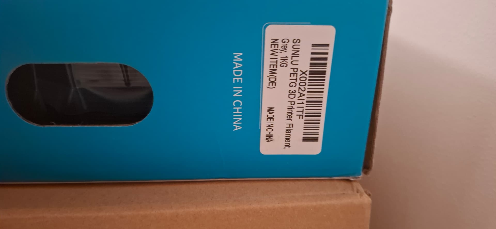

Never had Bambu Lab PETG HF in black, but white and gray. They’re matte. When I was forced to use Sunlu Black PETG, due to no HF in stock at Bambu, I noticed a gloss similar to yours. Please keep in mind I used HF White and Gray > no gloss at all.
Sunlu has PETG and HS PETG Matte, I have the Matte, it was so cheap I had to try.
It didn’t print so well at first it was matte but bad prints, until I lowered the temp as John said to 230 then it does well
I think a keeper
See above. Used Sunlus “normal” PETG in black. Photos show a colo(u)r I haven’t used so far, it’s the same type.
Results:
Compared to Bambu Lab PETG HF which is more matte > Sunlu PETG is glossy.
Edit: Sunlu works just fine with Bambu PETG HF profile IMO.
