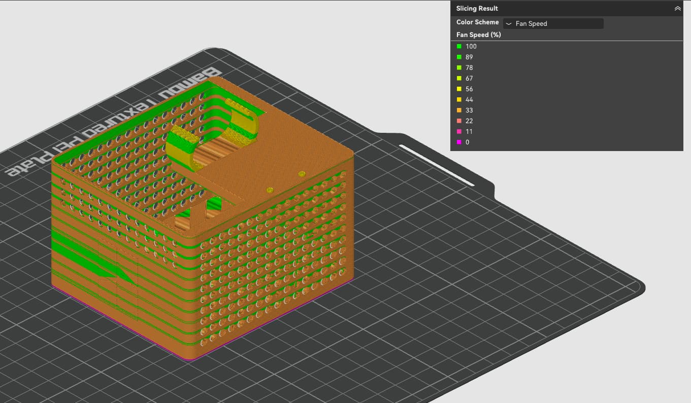

In printing Compact poop bucket L (A1, A1 mini) - Free 3D Print Model - MakerWorld I see banding that is at the same layers as the holes in the side. I am guessing that this is related to those layers taking much longer to print that the ones without holes. Past that, I could use some suggestions as to what to adjust to try to eliminate this kind of defect in the future.
It was printed using the 0.20 mm Standard @BBL A1 with Bambu PETG HF selected as the filament. 2 Wall loops (default) and I don’t see indications of any overrides.

I just went through this issue on an H2D! For me it was the pre start fan time in the fillament settings. It is set to 2 seconds, I switched it to 0 seconds and the prints turned out much better. Original user who helped me was @hotellonely, just figured I would give credit where due if it helps you.
Thanks for the pointer. I think the thread and post you referred to is Layer shifts with solid layers or patterns? On vertical walls - #11 by hotellonely Clearly explained there is why eliminating the pre start fan time makes sense for PETG and this kind of overhang-rich printing.
I’m giving it a shot.
Here is Bambu Slicer defaults, including the 2 s pre start fan time
[Setting the pre start fan time to zero,] Bambu Slicer now shows the fan speed as generally constant at its 30% baseline.
Changing the pre start fan time to zero cleaned up the banding and didn’t seem to have significant impact on the overhang/bridge appearance on the holes. I do see some defects in the raised logo, but figuring out how to locally modify the parameters will be a learning experience for another day.
