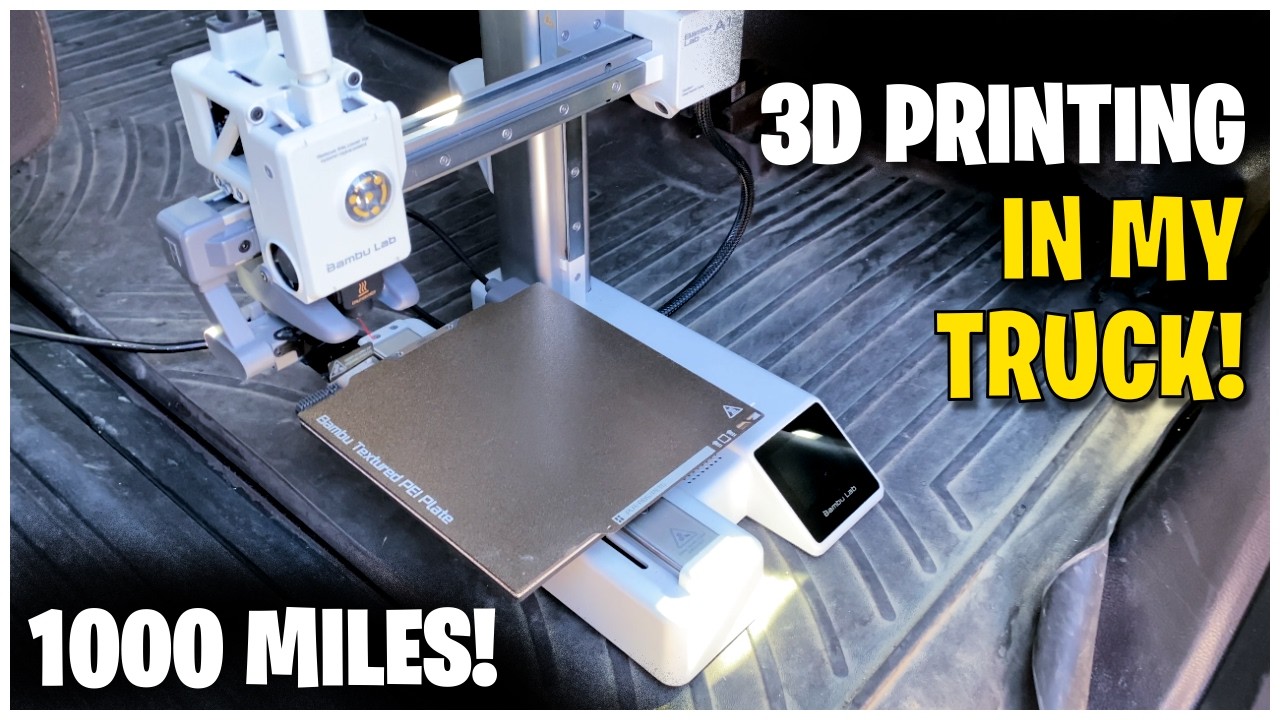

I don’t think the motion of the boat will matter all that much. 3D printers have advanced a long way and these newer printers are able to handle a lot more and not lose quality.
Here’s some examples of printers operating in undesirable conditions:
Both of the above examples are bed slingers and I’d imagine that a CoreXY printer link the P1 series , X1 series, or H2D would be even more stable. I think as long as you have it properly anchored so it doesn’t slide off the surface it’s sitting on, you should be okay.
