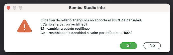

Bambu Studio crash over this message
Hi there guys! I’m newbie here at forum , hope I can help you as well in a future.
Atm, my Bambu Studio app crash when I tried to start it, appears this message:
Translation: “The triangle fill pattern does not support 100% density filling. Change the pattern to straight?”
Doesnt matter if I press any button, “yes” or “no” button, whatever, it crashes…
I still try out on Windows and MacOS and also tried to delete de apps, no way…
Anyone can help me please?

This is normal. If you want the infill to be 100% (solid plastic) you need to select “yes” to change the infill pattern.
Hi! I’m sure about that, but cannot update it, when i choose any option, the program crash…
Any recommendation?
Sorry, I did not realize that was the problem. You might try re-installing Bambu Studio. The recent releases seem to cause trouble for some people and is solved by re-installing.
Had this issue.
Seems related to an old and/or corrupt process file in a .3mf.
Once I figured out which file was causing it, I deleted all the processes in library/applicationsupport/bambustudio/user/<user#>/process so I could open bambu studio
then loaded the file
then resaved the processes
then resaved the file
