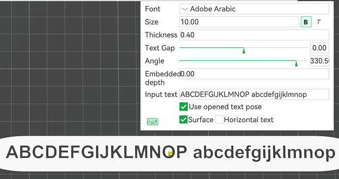

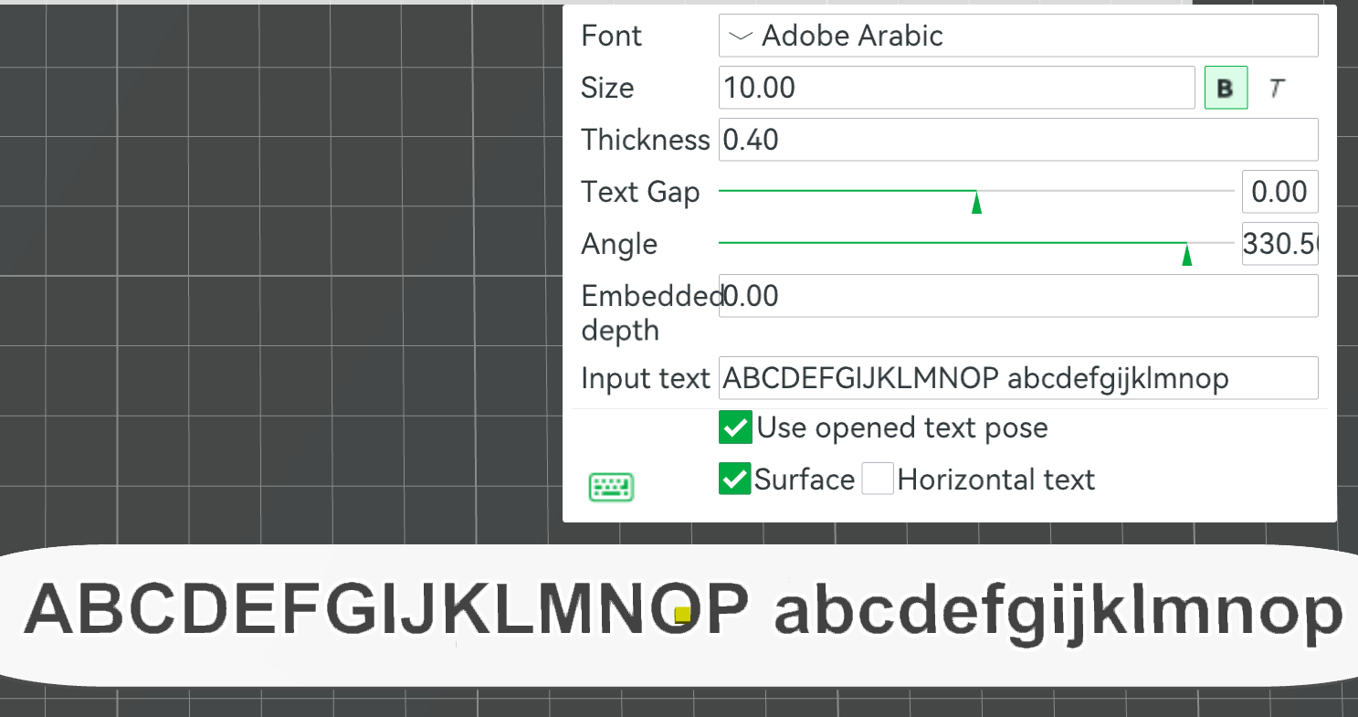

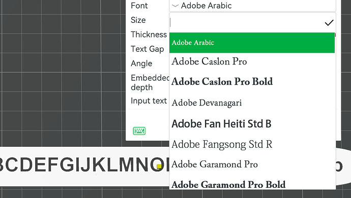

ok. This is what i see in the old version.
Actually, I take that back. It is some blank / missing font???
However, in the old version I can edit the text and it stays this font. In the new BS, it defaults to Arial and it changes what it looks like. It gets thinner.
The empty space with the checkmark? No, it’s a font search feature, which I just figured out. And in the prior shot you posted, the actual font looks like Arial to me.
-M

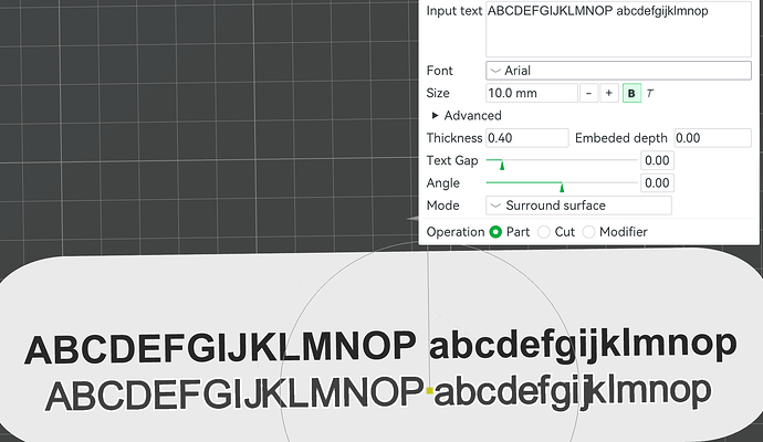

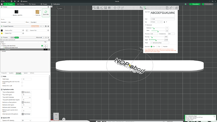

Well when this file opens in my BS it the text looks like a bold(er) Arial (though may not be). But as soon as I click to edit it, this happens:
So at that point I have no idea if what it is showing in the text/font settings has any relation to what was there originally. :face_with_diagonal_mouth:
Actually… LOL… if I hit “undo” while that text editor is open with the skewed text showing, then it goes back to being in the correct orientation again, and the text dialog stays open also, with the angle reset to zero. Then I hit undo and/or redo a couple times and the whole program crashed. Uh, sorry, that doesn’t help, but I found it amusing.

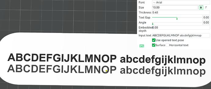

You are right, but something is still different.
In the old version, I can change it to Arial and it retains its look.
In the new version, when i click into it (“edit text”) it becomes much thinner.
If I try Bold, it seems to have a pronounced text spacing issue:
…. And since I am at it… some characters look different, eg. the top angle at G
I see the text kerning issue with some characters as well, and with other fonts also. Adjusting Text Gap helps separate the “j” and “k” but the overall spacing is still off. No idea why. The layout engine seems to have some strange ideas about kerning in general (“text gap?”), even a monospace font looks off. Is it trying to fit the text onto the part surface and changing the spacing to do that?
The options are also very limited, really (compared to everything a modern font can do). I haven’t used the text tool much so far so maybe I’m missing something.
As for identifying your mystery font… that’s tough, it’s so close to Arial. I knew I guy once who could have named it on the spot, but… I could see if I can find him :slight_smile: Did you try asking an AI like CGPT? Or maybe Google has a search feature for that?

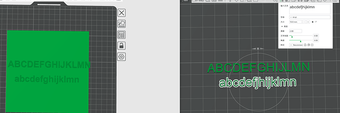

After all this testing, I now think that it is Arial, just some weird rendering in the new Bambu Studio.
I don’t use the text feature much either. I saved a copy of the older version, and I suppose I can just install that temporarily if I need to edit any text - at least until (or if) Bambu fixes this issue.
I found the portable version, so that makes it a bit easier.
The left side shows version 2.1.1, and the right side shows the latest version.
