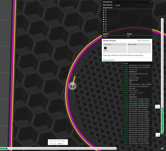

Hi Ceej,
Could you post your project file, or an example that recreates the issue? I’m having trouble understanding/recreating the exact situation.
For example here’s a simple model of a cylinder completely inside a cube. They’re set to have different number of walls and infill density. I have set the wall speed settings to be the same as yours (35/45).
Here it is starting the inner wall of the inner separation between parts:
And here it is starting on the “outer” wall of the inner separation:
The g-code looks correct. But I imagine your situation isn’t as simple.
You probably know already, but that’s just the speed for that move, w/out extrusion. It’s moving to the next position (where the wall starts in this case). So I’d expect the extrusion speed to be changed before actual extrusion. Though the question of why it is setting the wrong speed in your case still remains!
