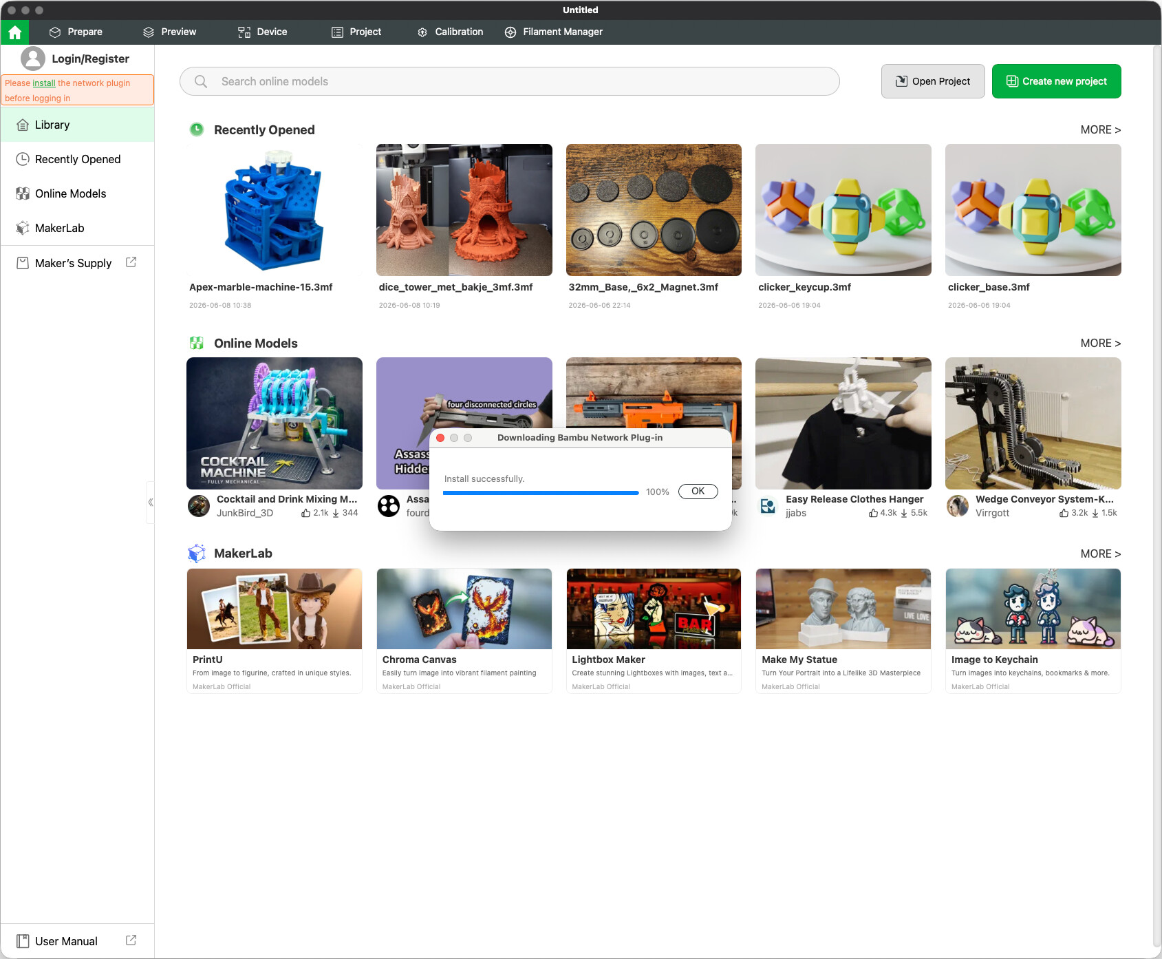

Bambu Studio not working on Mac OS 27
Since upgrading to Mac OS 27 on Monday, Bambu Studio is stuck in a loop where it downloads the Network Plugin and installs it and then keeps doing it forever.
Yep, Same for me. Seeing the same experience after Mac OS 27.
This works after reading through the git https://github.com/bambulab/BambuStudio/issues/11084#issuecomment-4657489494
Go to Application folder, find ‘Bambu Studio’ and right click it, go information, and check the ‘Run with rosetta’ option. It makes work fine in macOS 27 Beta.
The issue is back after upgrading to beta 3.
