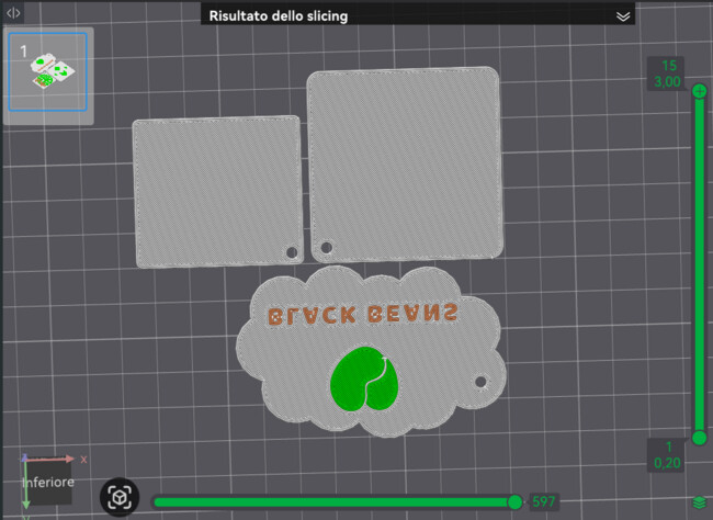

However, when I did the slicing, the result was different:
For two objects, the coloring is only done on the upper part, leaving the base a single color.
For the third one, the coloring “pierces” the bottom and can also be seen on the bottom side.
I tried printing the gcode created in this way, and the print result is what you see in the preview.
Can anyone tell me why these differences occur?

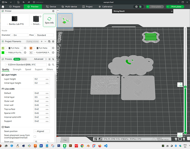

But you can easily fix it by, choose an object, goto paint and fill the white plate with white again.
esempio fixed.3mf (329.2 KB)

@user_3110569737 your method works even if the slice result isn’t “really perfect”… as you can see in the image, the green/orange coloring starts with the fourth layer, while in the other pieces it starts with the eighth layer… but I still think it’s a good compromise.
Regarding @Tolik979 suggestion, I tried using the paint tool. If I use the “Stesso colore connesso” option (I’m using the Italian version… I think it corresponds to “fill/connect same color”), the color also ends up on the underside…

In the fixed file I attached I see the color shift in layer 7 and 8. That’s strange you see it at layer 4
