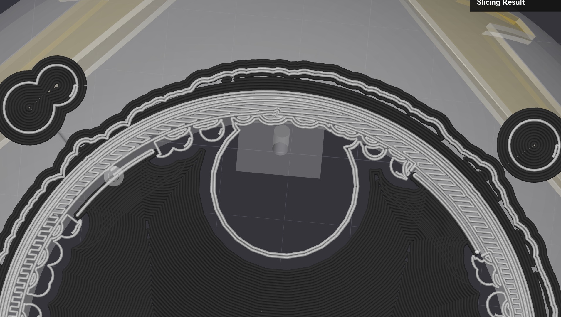

Hi,
I am currently experiencing a problem that the 2nd layer (and only that as far as I can see) is being generated in the wrong order and is built in thin air (therefor is a complete mess which leads to an ugly print). No matter how I try to generate the wall order, it always stays the same.. any idea?
View 1: A few steps into layer 2… black is layer 1, white is layer 2 (in the air)

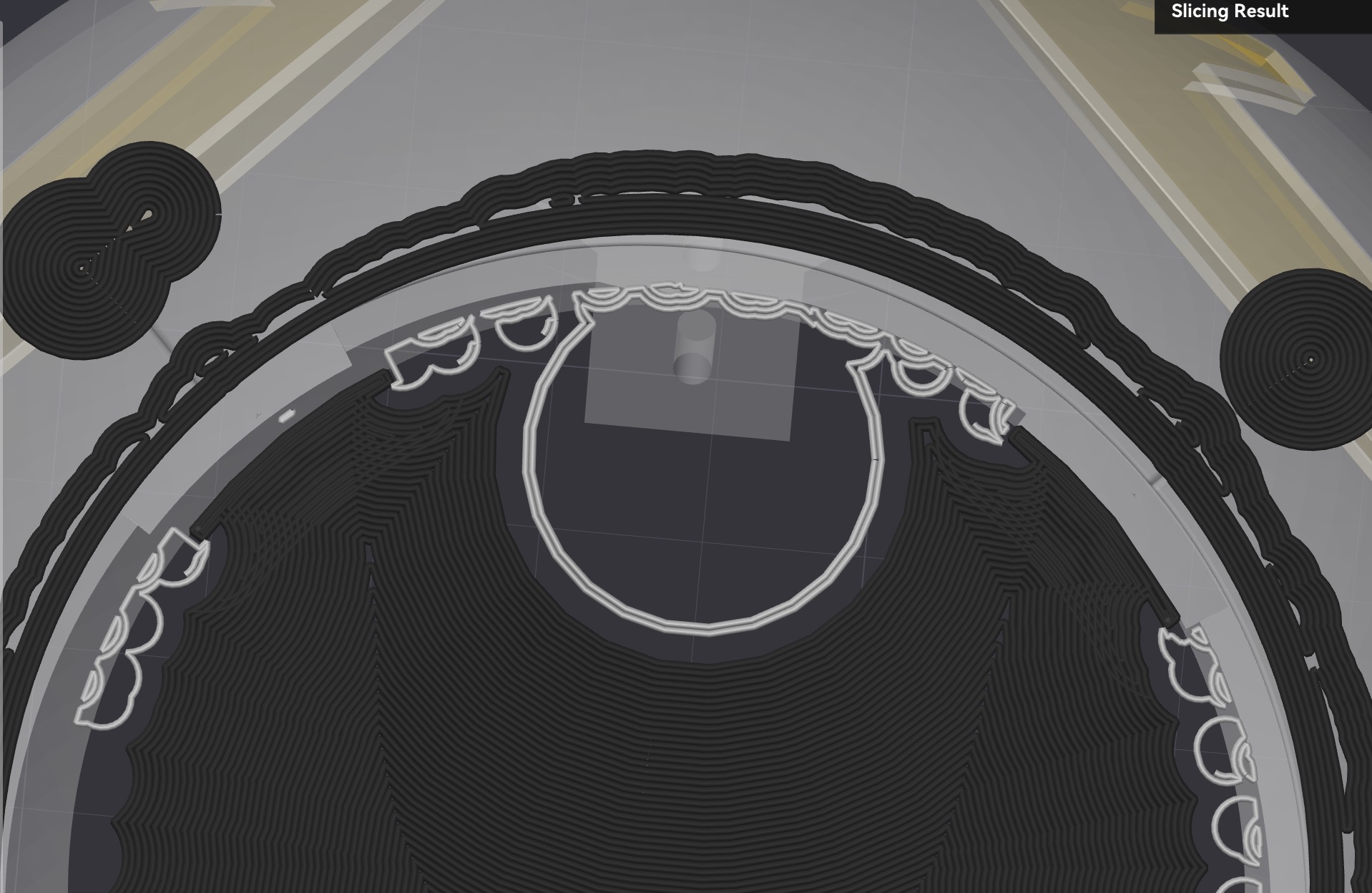

View 2: Whole layer 2… if printed in the right order this would work… starting from layer 3 the order is right again but layer 2 errors are being propagated in the print.
Bambu Studio 2.6.0.51
Ok… changing the support style from “Tree small” to “Tree Hybrid” indirectly did the trick.. not because the generation was in the same order then but because with hybrid there was something on layer1 in the corresponding areas for layer2 … :expressionless_face:
