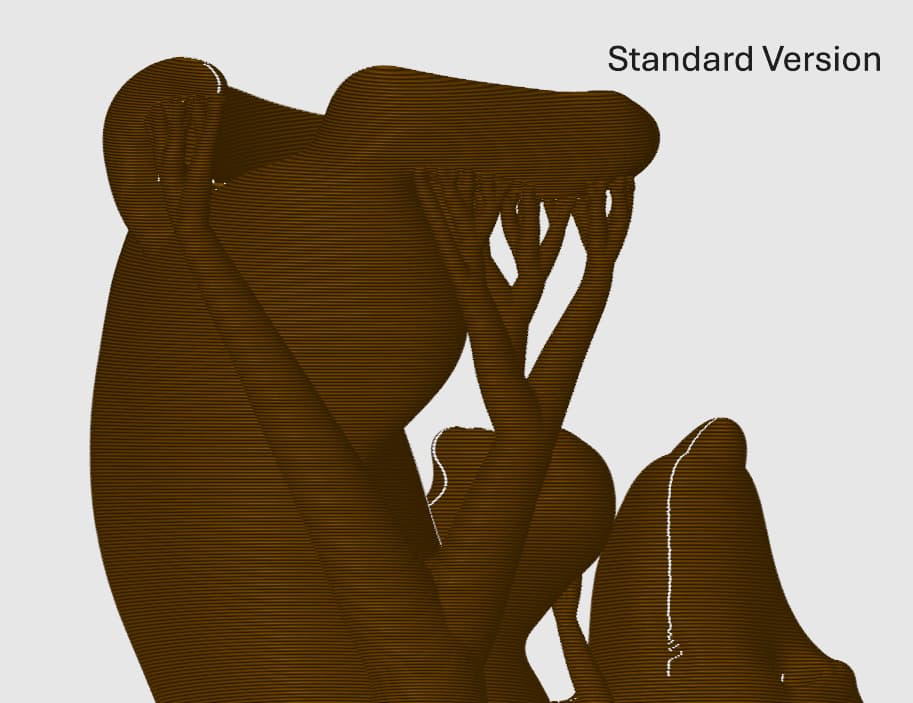

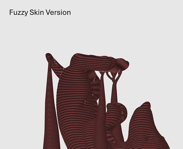

Hi,
New to Bambu Studio since getting a P2s.
I found this wine bottle holder on makerworld.
I tried print the fuzzy skin version 3 times and it failed every time near the end of the print with the back legs of the dog. First time the support fell off the bed, and the next 2 times, both supports for the feet fell off the bed.
I then looked at the original designer version and found the supports for the back legs are so much better supports for the back legs. it printed perfectly first time. I even tried the aux fan vent mod with no success, thinking it might be the fan blowing the supports off.
Attached are pics of the 2 designs after I have sliced them with all standard settings from the profiles. Is the fuzzy skin supports supposed to that few? Compared to the fuzzy skin version, the standard version has lots of supports. Other people seem to be able to print the fuzzy skin version no problem.
I don’t know what I am doing wrong??? Can anyone help???
Try playing with these settings , re orientate the model , change the support type

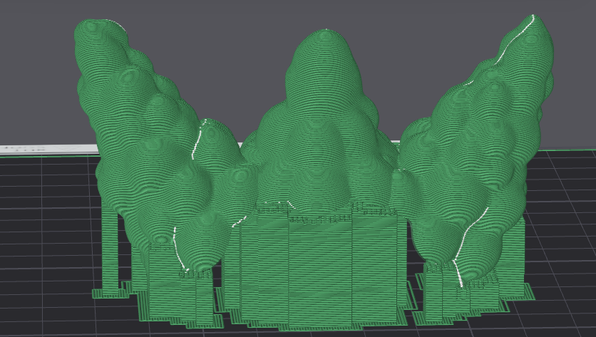

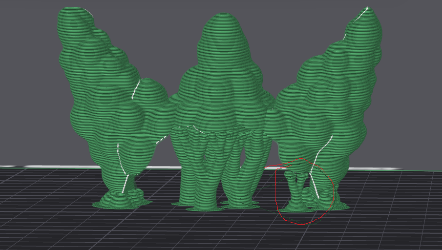

bad and good supports the circled tree support fails constantly ,others may have varying outcomes
