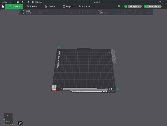

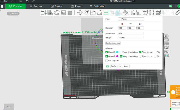

When I use Bambu Studio and I try to use the cut tool or the manual support tool- the UI for the tool IS ALWAYS OVER THE MODEL I’m trying to edit!
Is there a way to undock the tools and move it somewhere? I’m constantly fighting with the UI hanging over the model so I can’t see what I’m working on.

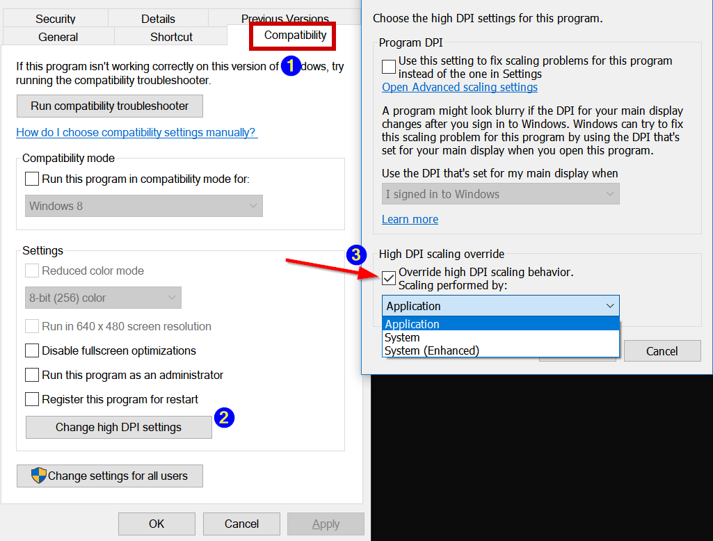

Workaround #1 – Windows per-app DPI override
This is the only real lever you can pull from outside the software.
Right-click the Bambu Studio icon in your taskbar → Properties
  1. Go to the Compatibility tab
  2. Click “Change High DPI Settings”
  3. Enable “High DPI scaling override”
  • Experiment with Application, System, or System Enhanced
You might need to log out and back in for the changes to take effect. A full reboot sometimes helps. The internal platform that Bambu uses behaves inconsistently depending on your GPU drivers, so your mileage will vary and you may need to experiment with other settings like Program DPI located at the top of the menu.
This won’t magically fix the UI, but it may shrink the menus enough to make the workspace usable.

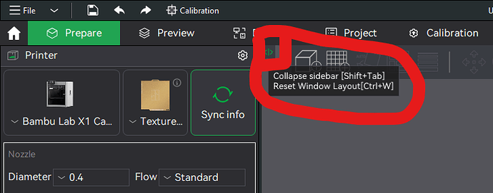

In BS you can colapse side bar:
Once you collapse the side bar- the tools are still over the model. I’m not following…
To be clear- I want to use the cut tool and see my model and surface at the same time. I can’t use the tool settings with it blocking the view of the model.
Thanks I’m going to try some of these ideas. I really wish the menu would just pop out to the side (even if it’s not move-able). Geez Bambu… I love ya but really?
You have to move the plate to the left before selecting the tool.

I was about to make the same topic before seeing this one. It wasn’t clear to me what you meant by moving the plate to the left since there’s no such obvious option. I was able to do this by adding a plate, not sure if that’s what you meant.
You simply grab the plate with the center button of the mouse and move it to the left.

Thanks, that’s actually a huge help.
