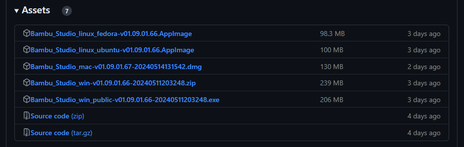

I am not sure how thats happening, I also keep the files, and multiple versions of BETA and STABLE going back months and months almost a year when I got my printer. I dont get or see diffferent versions of the latest V1.9.1.66 for windows - I frequent the links and do fresh downloads when I am validating a bug in a VM and have done this multiple times over thje last, 4 days ago, 2 days ago, today, the file is the same. (for windows)
For me…
Git hub link hasnt been updated in days…
Software download page hasnt been updated in days…
Downloading from here - Software | Bambu Lab
Or downloading from here - Releases · bambulab/BambuStudio · GitHub
The files are the same, dated approx 3 days ago, same time, same security seal, and do not change the date, time or filename (BL???) when I download them from those two trusted sources across multiple times different days (to verify the fan issue etc).
Windows Filename :- Bambu_Studio_win_public-v01.09.01.66-20240511203248.exe
I am not trying to convice you to upgrade or debate if Bambu have \ have not got file sync issues, although my experience clearly differs from yours and find no evidence of changing versions (apart from MAC which did get a minor release increase for a change, to v.67 - but I am talking Windows)

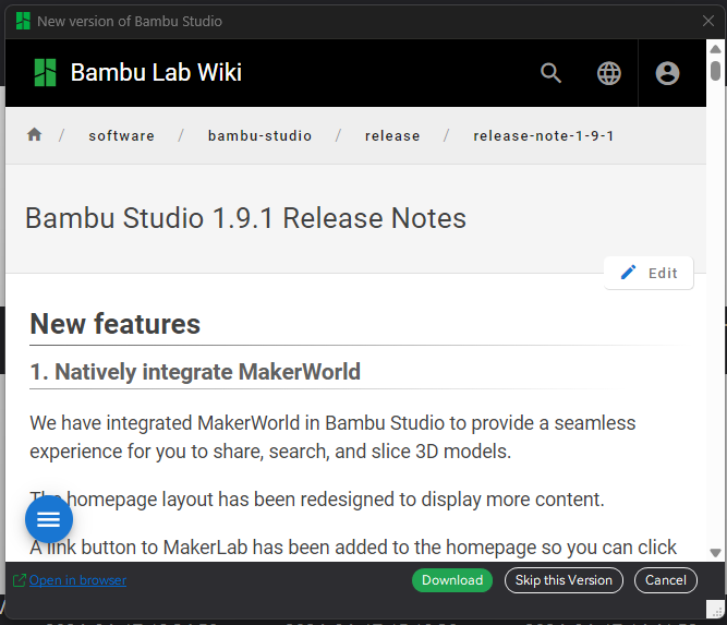

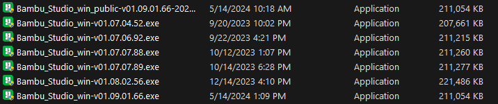

Yep, that’s where I got the “win-public” version you show. That may have been the first time I used that link. I usually wait for Bambu Studio to let me know there’s a new version. I’m just saying there shouldn’t be different names from two different places.
Here’s a screen grab of my files followed by the notice BS gives with a download button. It downloads a “different” file and it shouldn’t. They should stick with one naming convention so it doesn’t confuse people. :smirk:
My apologies to the OP @SneakySmurf for high jacking the thread. I didn’t mean to. Honest.
I havent updated the new Bambu Studio yet but I did for my X1C and has been running fine.

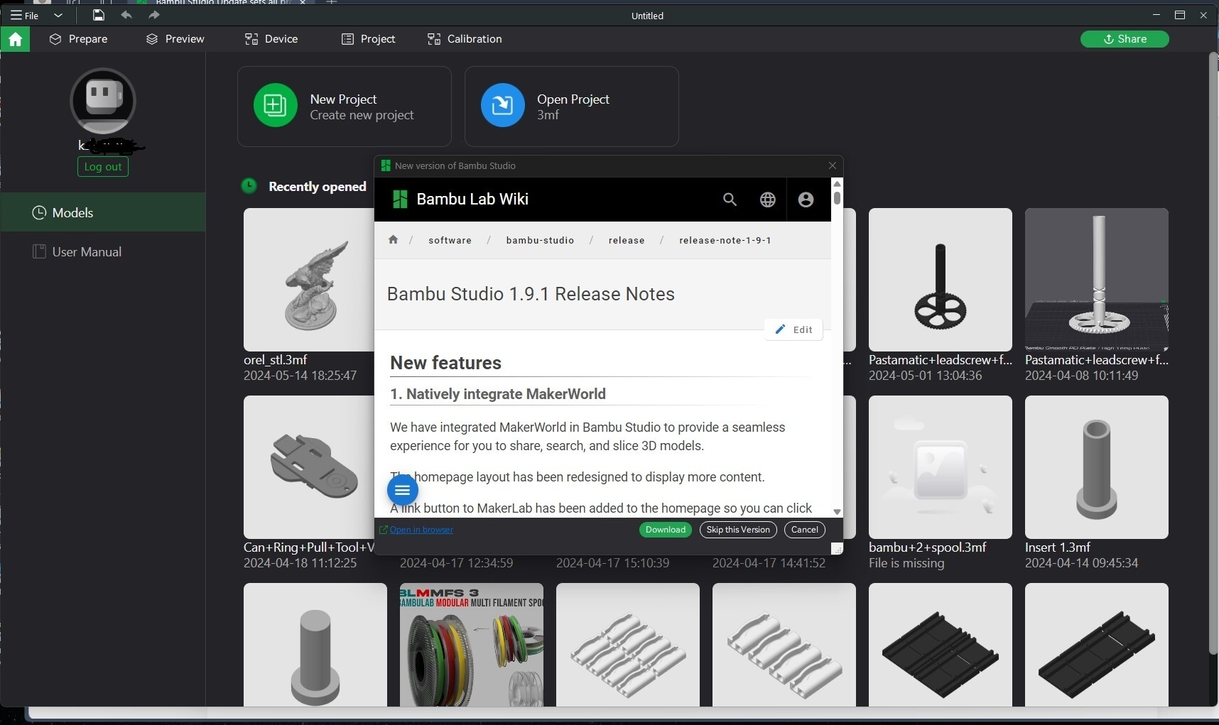

Its all learning. I actually never see that "notification\wiki link’ you just shared, and if thats a different file name yet again, abit wierd - agreed. Does that prompt you from within Studio itself like that?
Yes. That pops up and overlays Bambu Studio. Here’s a full screen image.
