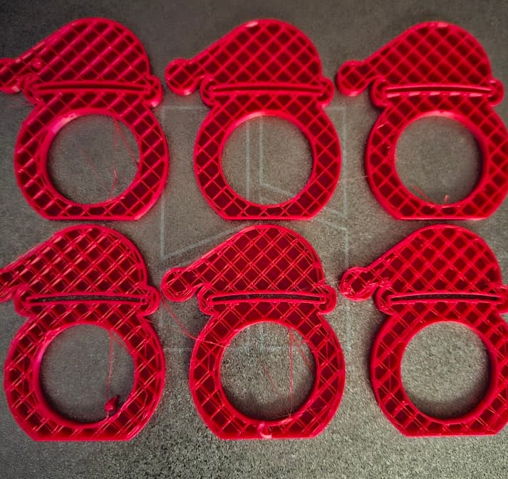

Today, I got another issue with the A4 location of my AMS Lite.
I launched a print using location A4 to finish a spool, and got another one on the A3 locztion. Same filament, so i could use the auto refill function.
I was phisically there to see that the auto refill function worked good, and it was done correctly. I waited 2 more minutes before going "afp’’ (away from printer).
When I came back after ~1h, I was suprised to not here the printer printing. In fact, the print stopped, and the mini control screen show an error from the assistant : " spool in A4 location is empty " and so , that let my printer nozzle on the piece so, the piece melted, and there was dropplets that cooled and made the pieces not usable again…
So that AMS issue make my plate of 6 pieces just a waste.
I tried to “unpaused” the print, but 4 pieces on 6 got screwed cause of the cooled dropplets.
Sad that this happened, cause I was there for the auto refill phasis and the issue poped after the A3 location was correctly running…
And so , the print failed, on 4 pieces of 6
