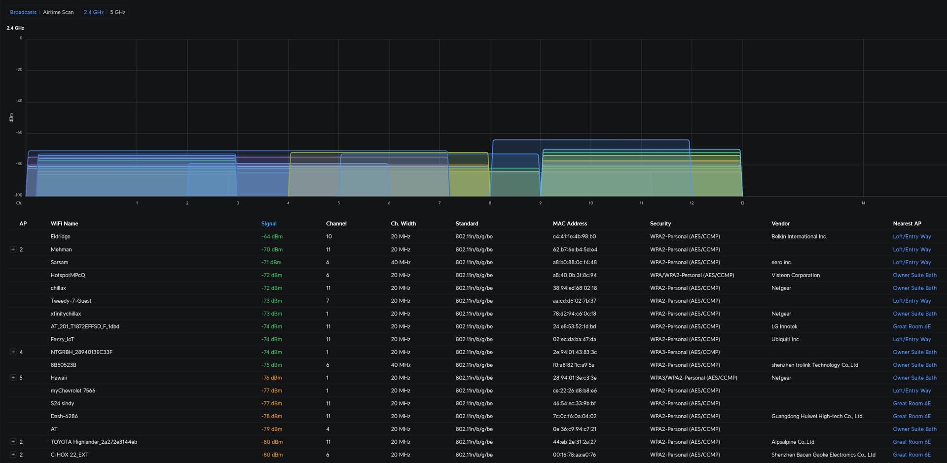

There is no such thing as an unused channel where i am
48 networks within scanning radius
A separate SSID for IoT does not solve the full list of issues (security, perf, etc), nor does it solve issues with cochannel on 2.4ghz.
2.4Ghz is packed enough that the idea of a “dedicated channel for IoT” is insanity. there are only 3 non-overlapping 20Mhz channels on 2.4Ghz
for comparison 5Ghz has 24 non-overlapping 20Mhz channels (overlapping channels aren’t even allowed here like on 2.4Ghz) and 6Ghz has 60 (in the US, in low power indoor)
