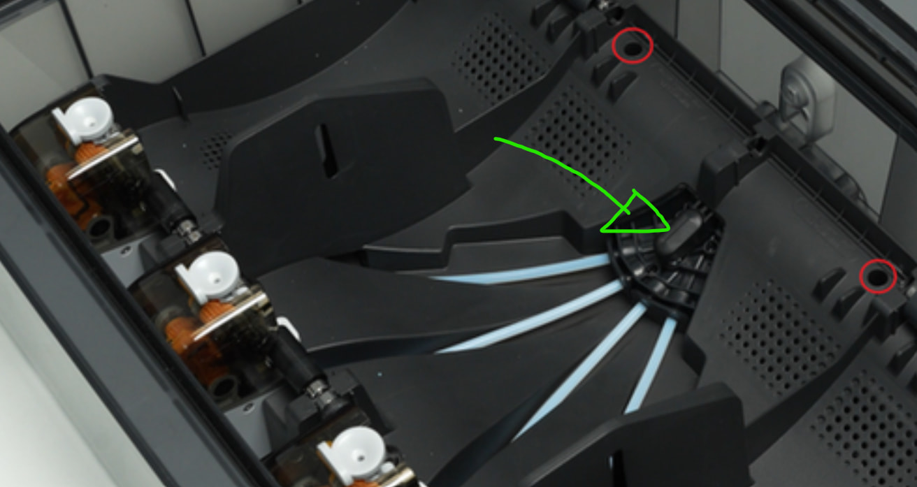

Update on the X2D AMS 2 Pro Feeder issues. Support is sending me a replacement AMS 2 Pro Internal Hub Unit. For those with grinding/feeding issues, try and repro the issue in a slot that isnt slot 3. When the grinding/feed issue happens you will see a black lever at the point where the 4 PTFE tubes meet at the back of this slot. Push lever down and your filament will now feed. Seems there is a defect with the lever on the Hubs shipped with X2D AMS 2’s. Open a support ticket right away to get your replacement part.
