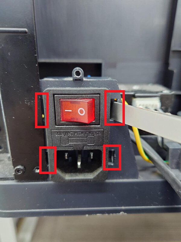

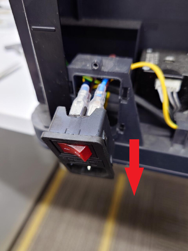

Michael, message SupportAssistant the ticket number so they can help on their end but in the meantime you can also try this:
  1. Unplug the printer
  2. Take the back panel off
  3. Make sure the crimped connectors are all pushed firmly on to the back of the power switch assembly.
Here’s the whole step by step to get you to that point.
You probably don’t need to replace the assembly, there’s a good chance that one of the connectors has vibrated loose.

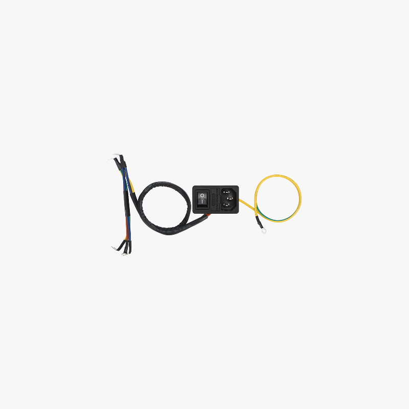

It is strange, and I tried to find it in the store before I posted because I swear it used to be available. 3rd party stores are selling it as part #FAC054.
I’m pretty sure the one you linked is the same switch so I’m not sure why they list it as only being compatible with the P2 series.

The switch on the P1S includes the cables BUT if the switch fits the X1C then it is a good result. You do not have to use the cables.

Yes they’re the same, P1S, P2S or X1C. I think even the cables are the same, don’t know why BL doesn’t list them together
Possibly because the P1S is RED and lighted when on. This one (P2S) is black and doesn’t appear to be lighted? Sounds like a weak reason but it wouldn’t surprise me.
