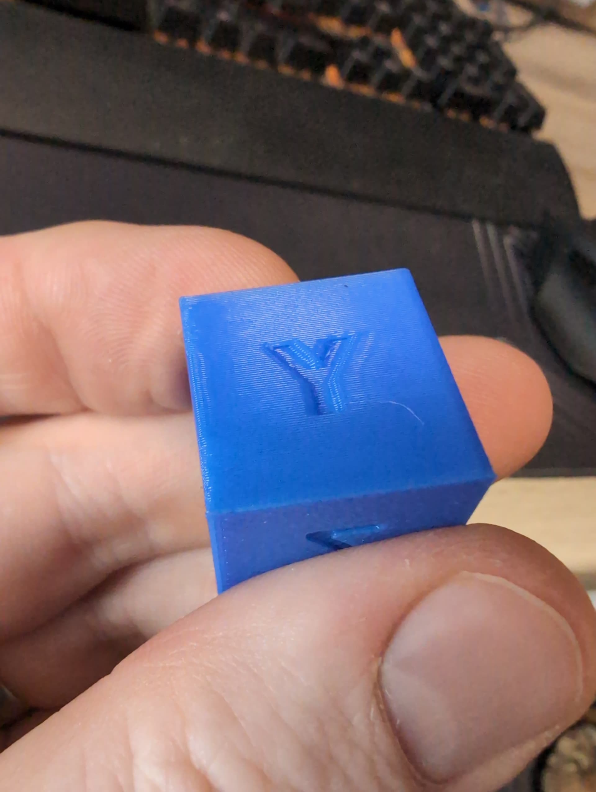

I’ve printed a number of things and noticed on some (especially on non bambu filament) that I have banding (my word for it) and some ringing (see the image).

Not that I have fully fixed it, but the belt tensioner for the Y axis is the top one… you undo the bottom screw, and its really not clear, but the only bit that can move is the top bit… I have moved that and printing a calibration cube currently.
What a difference properly tightening the Y belt made… went from loads of rining to almost none - looking at a rining stress test its not perfect… but better than it was. I think the machine will always have some rining… but the difference is night & day

Images of my calibration cube + ringing test.
There’s still a bit of ringing there, but looks a lot better than it did. Did you run the calibration again after you tightened the belts?
I did. and I’m stumped as to how to fix it any more… but it’s a huge improvement.
Any suggestions?
Could tpu (95A hardness) feet be causing issues?
Thanks
I can’t see why they would. If you’ve run the calibration with them on, then that should be accounted for anyway.
I’m sure they look better in person, as that’s an extreme angle and a colour that probably shows a lot of defects. It certainly has much more consistent layer lines, so it’s a big improvement.
Hopefully someone with an A1 will be along soon to say how they compare to theirs. It’s certainly better than my X1C but that has a faulty accelerometer apparently. I’m hanging out in the A1 camp as I’m considering jumping ship.
